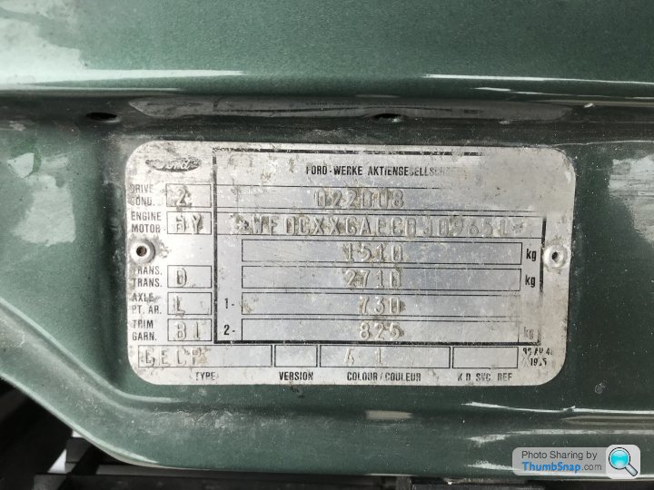

I`d have said that was it, but on checking my original V5 I found this. Don`t know what the first 6 letters mean but it does make 17?:

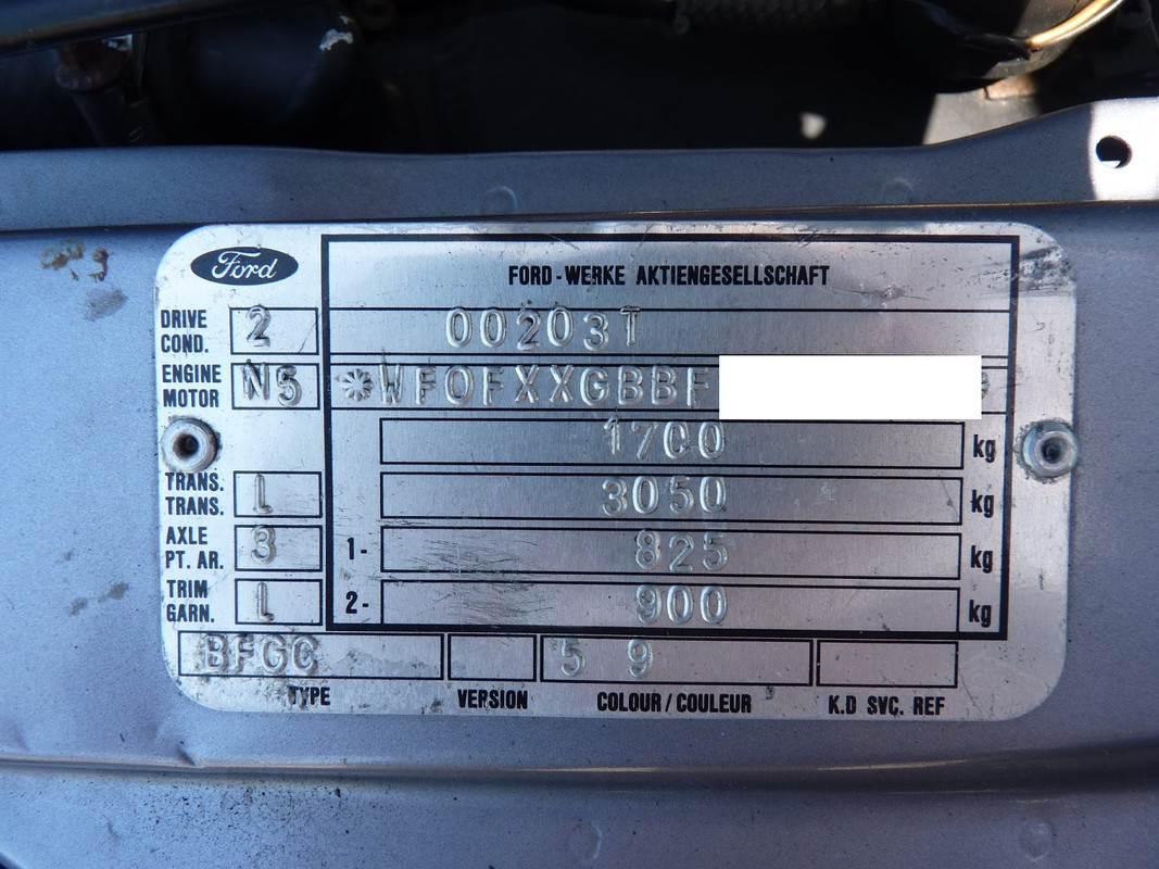

EDIT: just looked, and it IS (or should) all be on the VIN plate. Also Andrew`s xorrect, of course, there are 5 numbers for the engine. If you can`t see it, try the side of seat. (Deliberate blurring of some numbers)
(To post images use tis https://postimages.org/ and copy `hotlink for forums`)

It does appear on mine, although it is a repro.
I searched for photos and found some more where the full number does appear on the plate:
Maybe it depends on the date of manufacture. I notice also how the style of asterisk have changed over the years.
As you say though, the stamped alpha-numeric identifier on the floor should be the correct one of 17 digits to write on the DVLA form.
