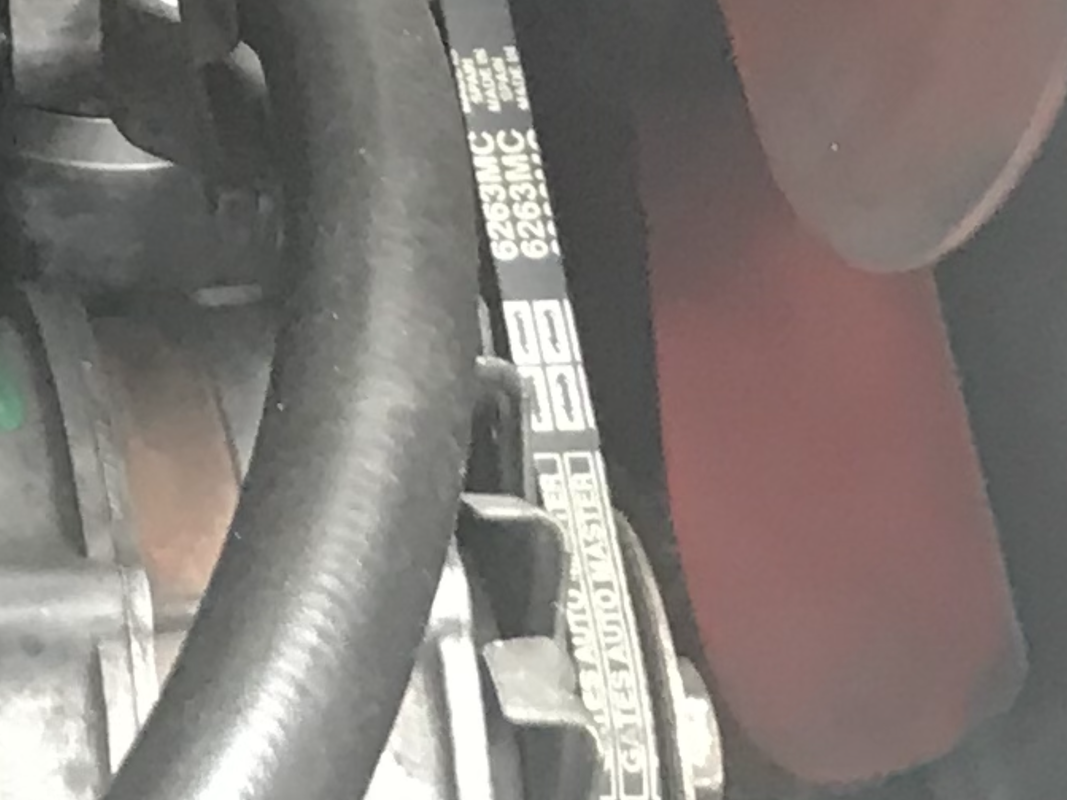

I can confirm that is the correct size as I have that belt fitted on mine what Tickover did 2 years ago . But wait a question is your engine the original ? Or was your laser originally a 1.6 ?

I only ask as I think the 1.6 has a different alternator to the 2.0 one
Here’s a picture with mine , it also shows the right part number .
