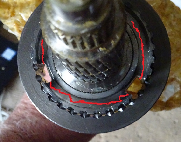

I`ve never had this in a Ford `box, cos they`re quite rugged, but I did in an old Vauxhall RWD: the hub is splined onto the mainshaft and they would crack around the `webbing`.
The inner part is the mainshaft, the outer ring slides for and aft to engage with the gears on either side of the hub. The hub can crack where marked. The selector fork stops it all falling apart, but theres so much play the engagement is very `draggy`.and there will be lots of your clunking noisees. Let`s just hope it`s your clutch, whatever, it`s very likely a gearbox out job.

So from what your saying it does seem to be the synchro.

The synchro though wouldn`t really explain the violent surging as you just described it `dumping the clutch`, that`s much more like a clutch, or even engine/gearbox mount - which I guess could also make noise? Or as Martin said a fuelling issue?
