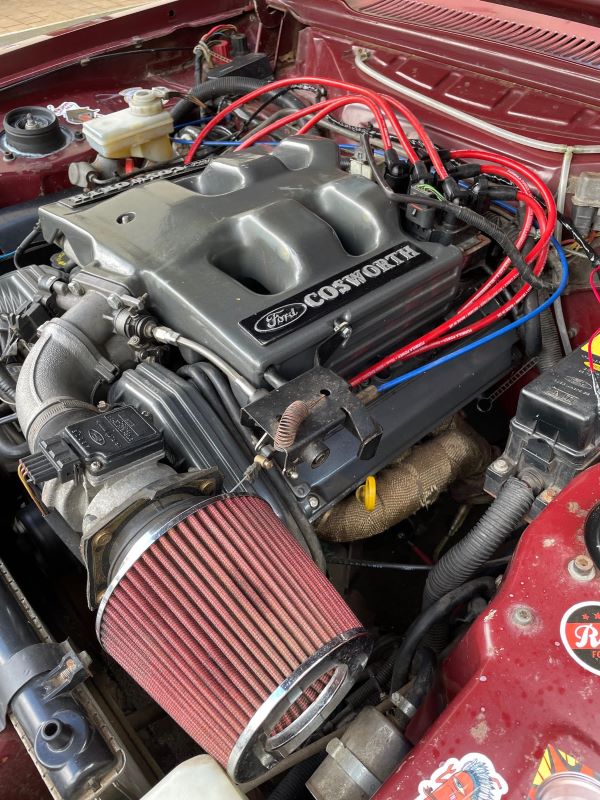

It’s at this stage I should point out it is no longer a 1.6 Pinto

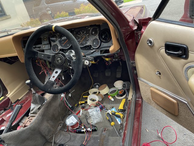

And while everything is out I’ve been running new wiring for a new stereo.
The wiring loom is in two parts due to the engine conversion, with the entire Capri loom on a battery cut off isolator which acts as an immobiliser. The engine loom and fuse box is connected to power separately in order to provide continuous power to the ECU but it’s impossible to start the car without the cutout switch key in place.
I’ve taken a feed from this engine fuse box to run a permanent live for the stereo, and run a new ignition feed for it from the Capri fuse box. I’ve run new speaker wires. I’m doing away with the clock so I’ve used its bulb wiring to provide a lighting signal feed to the stereo.
I’ve removed the cig lighter and replaced with a USB socket which will power the MagSafe charger, and the new stereo will also have USB in at the rear, keeping it all hidden.
I’ve also run switched live feeds into the rear to a second 2 gang USB charger for the kids’ tablets on long journeys.
I’ve cut the Mk2 door cards to mount new Alpine speakers, re-using the 2.8 speaker covers
Current state as at today is:

Next at the end of August is a new gearbox (currently on a late type 9, going to a custom type 9 with stronger internals) new brake servo, rebuild steering rack (leaky and groaning) and some engine seal TLC (I’ve lost count how many leaks it has)!

Re: Ex Laser rolling project
Posted: Fri Aug 05, 2022 12:39 pm
by Wickedbad
Just new leads today, from Formula Power.
https://www.formulapower.com/high-performance-leads/
Magnecor don't get great reviews sometimes, these do and much cheaper. Will report back!
