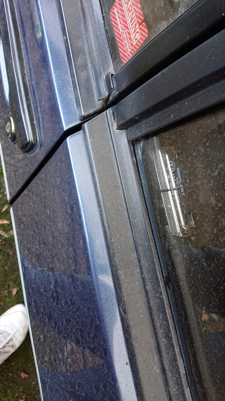

Can anyone share pics or info on how their Mk3 rear quarter light windows are sealed, the type that do not open. Mine seem to be bonded in and then there is a gap on the outside face where the plastic strip does not meet the glass, is this normal, can water get into the car, etc

mine is stuck in with the black sealant and like Mr B, the plastic trim on the outside touches the glass at the back but has about a 5 mm gap at the front where it joins the vertical trim. just looks like somethings missing but maybe this is another one of those Ford designs that we need to over look. What really concerns me is where is the water that runs down the window ending up if the glass is not sealed on the outside face.

I have a picture Jason but not sure how to load it up on here

That would be great Andrew, PM me your email address and I will send them over along with the picture of the rear window

Here's the photo of Mark's rear window trim.
Hopefully somebody will be able to tell if all fixed rear windows are the same or if something is amiss.

Doesn't look like the trim is properly fitted, it has a kink in it?. Might even be the upright trim is not right. This is mine

Your lower trim looks straight on the bottom edge and lines up with the door trim so I think the problem is the upright on the door pillar is not fitted properly and that is causing the kink in the window surround trim
