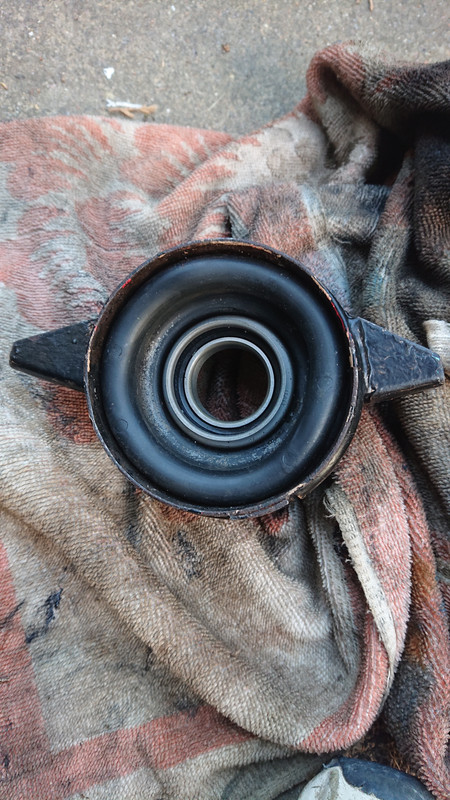

Looking under the 2.8 a little while back I spotted this split in the rubber on the central joint of the prop shaft.
I'm not sure if the rubber is available on its own but I found a kit for the whole central CV joint so decided to do a refurb. This is the kit

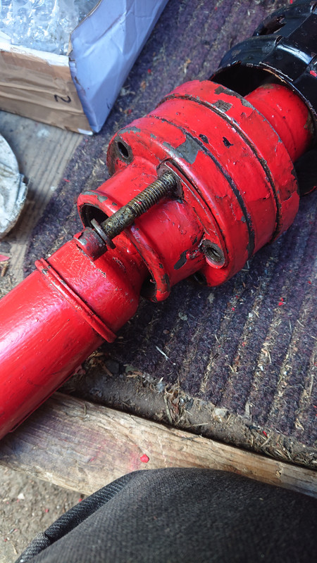

The joint is held together with 6 bolts which need to be removed
My shaft came apart with the bearing cage attached to this side - there are several large ball bearings in this cage.
This section is on a spline and will need a puller or a little brute force to get apart - brute force in my case hence the dented housing!

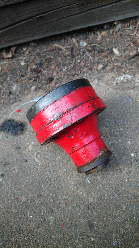

This is the other half

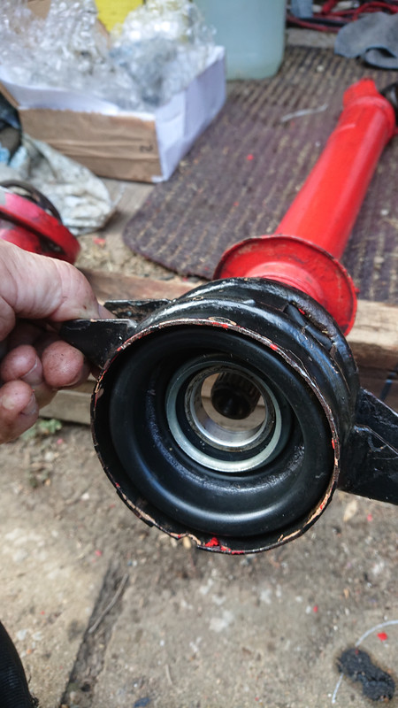

There is a bolt in the centre which needs to be removed and then the central joint can be pulled free.
This allows access to the central bearing carrier
This should just slide off

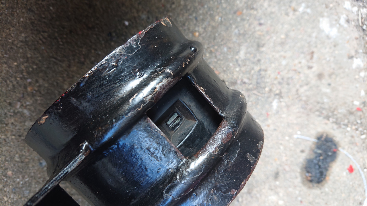

The centre breaks down in to 3 components
The rubber section is held in by metal tabs accessed through this hole
