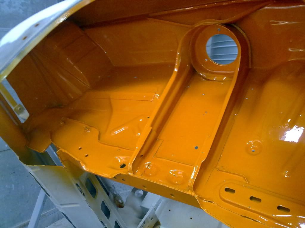

Here is some info which might help you out -
Yes the 3.0/2.8 shells have 7 extra plates each side around the front suspension, obvious ones under the bonnet - strut tops and corner brackets at back corners of the engine bay.
Under the wing you have a large plate bracing the strut tower to the inner wing. Then you have 4 more, the best one to tell if it is a V6 shell is the large one that ties in the roll bar mounts and the tower as this would be a pig to swap to a 4-cyl. as it goes behind the tower. This along with #4 strengthens the chassis rail along it's whole length.

You can see them on these cars. Not sure if all 2.8's would have had them, as you say they are not on the pic of the car you are looking at, may depend on year? Or even if these are repair plates. Someone else will advise.

These are the plates under the wing.
The small long one half way up the wing should not be there on the nearside for a 2.8 as it is a battery tray reinforcement. It would therefore be on the other side of a genuine 2.8 shell. This shot is a 3.0 shell which has mostly the same reinforcement plates

In your picture Peter am I right in thinking that the sections I've marked in red are the support plates, the green one is the battery tray, is the blue one part of the re-enforcement plates as well or not?

Yes they would be standard on 6 cylinder cars. Certainly they seem to be missing in the car Oilburner is looking at. Could be something to do with the restoration 11 years ago if they were cut out due to corrosion perhaps but you would expect them to be put back.

Yes Dan red and blue are standard strengthening plates on 6 cylinder shells. The green battery one obviously depends on which side the battery tray is so 4 pots and 3.0 litre is nearside and 2.8 and, I think, autos on the offside.
There are also a couple of small extra plates at the bottom of the tower - see the right hand edge of the bigger red circle.

I would say this car has a little history, according to the DVLA MOT site its been of the road or not MOTed between 2009 and 2019, the inner wings are 100% wrong for a 2.8, the nearside looks from the photo to rise towards the strut top so the strengthening plate may have been filled over, the drivers side looks flat, could be the photos, maybe its had new inner wing on the drivers side and they fitted a 4 cylinder one?. The strengthening plate normally rises at 45 degrees under the wing lip. Personally I would be asking a lot of questions if I really wanted the car
