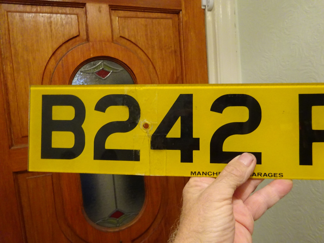

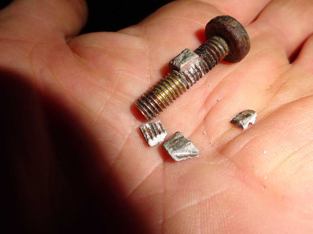

does anyone know what exactly the 2 screws holding the rear number plate actually screw into? I thought I`d take mine out & clean them up a bit, but neither will come out, they just turn as though in some kind of plastic lug which has stripped. Don`t seem able to get at the other side of the panel (box section?). If anyone knows what they`re going into I`d appreciate it.
(It does feel like it`s rotating smoothly, not got the `crunchy`, `grindy` feel of a corroded thread/nut. Have tried pulling whilst twisting with mole wrench to no avail)

Hi Steve,
Maybe/probably wrong, but I always assumed there are captive nuts welded to the inside of the rear panel to locate the screws.

Re: Rear No plate
That`s brilliant Andy, thanks! I kind of guessed it was something like that, only problem now is how to stop it turning as I can`t get at the other side
Wonder if I can prise the plastic lug out... or maybe just have a night of deoxy-gel and a dab of yellow paint.

Re: Rear No plate
Plastic lugs were such a ball ache - mine where ruined on all three cars
I eventually cut the bolts holding the plate in place off with a trusty angle grinder and just double-sided-taped the plate back in place again, much easier

Re: Rear No plate
These really are a hateful design. The clips push into the panel then as the screw is tightened the rivenut type thing in the plastic pulls up and "spreads the legs" of the clip, securing it in the panel. Unfortunately the screw then rusts into the rivenut and will not come undone.
I struggled for ages with mine and in the end had to break the number plate to remove it. I then sawed the remains of the screw off and centre punched the rivenut down the clip until it came out.
Refitting I was too tight to buy the new ones and just drilled the plate to go on with self tappers, having put a square of duct tape over each of the original holes to stop water getting in.
of a job, took quite a while to do.

Re: Rear No plate
You`re not kidding!!! I eventually managed to twist and pull hard enough with a mole wrench to pull the metal part through the plastic outer - this of course happened like an explosion - nearly broke my elbow on the bench behind, and OF COURSE, snapped the f****g number plate at the other fixing/. I got the screw & shite nut things out and even after I`d cut the `nut` with a splitter, even then, this piece was STILL stuck to the bolt (which is not even that rusty) :
Unbelievable! The crappiest design, with the poorest materials ever.
Andrew, very kind of you to offer, but of course I`ve already bought some off eBay, just the `nuts` for £6. So, instead of just putting a bit of yellow paint to disguise the slightly rusty bolt head, I now have to buy a new plate, new fittings, and have a really sore elbow. What`s the saying `if it ain`t broke...`
Just as a final moan, why oh why did they make a lug like that round? I `ve seen similar on other cars, but they`re square so they won`t turn, and nylon so they won`t corrode. Unbelievably poor.

Re: Rear No plate
Yes Paul, thanks for reminding me
Why, oh why, oh why can`t I just leave things alone? You`d think I`d have learned by now. But no, I`ll still try to fix a stone-chip and make it bigger and bigger till I have to respray the whole wing! I need protection from myself!!!
I have repaired the plate as much as possible till I get a new one, as you say, it`s the original from the dealer & has some sentimental value. Will try to make it a bit less visible over the winter, but it`ll possibly get me one more run out before It`s SORNed at end of the month. Gutted though, just gutted.

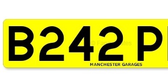

Re: Rear No plate
Thanks, yep, really don`t like the new font, the old one looks so much better, and was legal when the car was current so that`s what`s going on. I found this place in Ireland which give you a choice of 3 very slightly different styles of legal pre 2001 fonts, I just chose the one nearset to the original.80s-new-man wrote: ↑Sat Oct 26, 2019 10:16 amYou don’t wanna get crap euro / metric style lettering and not the proper 3 1/8” British style font.
https://www.fancyplates.com/buy-plates/uk-show-plates/
They`ll even put the dealer text along the bottom:

Re: Rear No plate
Paul,
it`s already in the post now, I`m quite happy with that as it`s an exact match, and TBH I don`t like putting things aside for later (unlike someone you know who`s insurance runs out Tuesday. £850 or £300: mmm need to think about that.)
