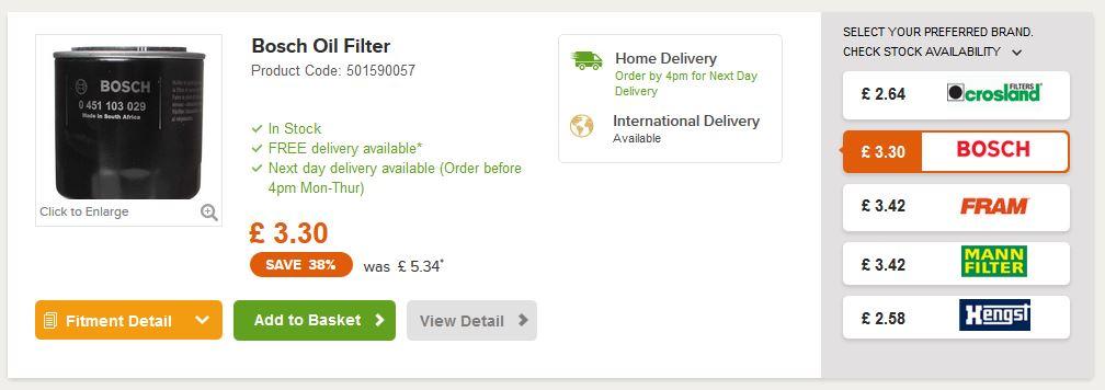

For service parts and the like, places like CarParts4Less are pretty good, just look at the prices of oil filters for example, and free delivery too -
