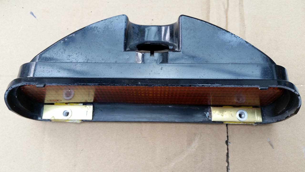

Spent the afternoon fixing the indicators mounts with brass strip and plastic, the epoxy should be dry tomorrow but I'm working so they'll have to wait. Bumper got a bit of wire brush treatment and is ready for rubbing down and painting.

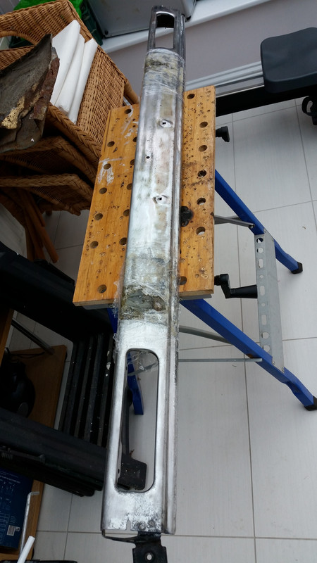

A messy afternoon in the garden, and I now have a shiny bare metal front bumper. Bit rusty behind the overriders, so now wrapped in clingfilm with a bit of DEOX Gel on it, likewise the mounts. Should be good for paint in the morning

For a change I remembered a piccy. Waiting overnight before stripping the clingfilm off. I think that will happen outside the conservatory, there's only so much the good lady will allow
Mounts are getting the same treatment and sat in a plastic bag.

With the clingfilm removed and the bumper + mounts washed off, only a small amount of surface rust remained in places not treated. I gave the rear of the bumper and the mounts a couple of coats of Hydrate 80 rust converter which seems to have worked well. Of course this needs 24hrs before painting, so something else to do instead. Apparently that involved the hedge trimmer, so after gardening I moved onto the indicators.
Both units have suffered the usual broken tabs, and last week I made up some brass strips with plasticard and glued in place with Devcon epoxy. As I discovered today when drilling through 7mm holes for the clinch-nuts, that doesn't stick well to the plastic moulding despite it having been well cleaned and keyed. My thoughts turned to super glue, but cyano doesn't work well with vibration, so I tested hot melt glue on the back of one of the units. Stuck like the proverbial, so onwards.
The end result, not hugely pretty, but very solid and functional. The units will be held in place with M5 bolts. I have since painted the brasswork matt black so the bits you can see (if you're laying on the floor...) don't stand out.

Yes that’s great , also no one will know the tabs are broke and also a lot stronger then them plastic tabs .
