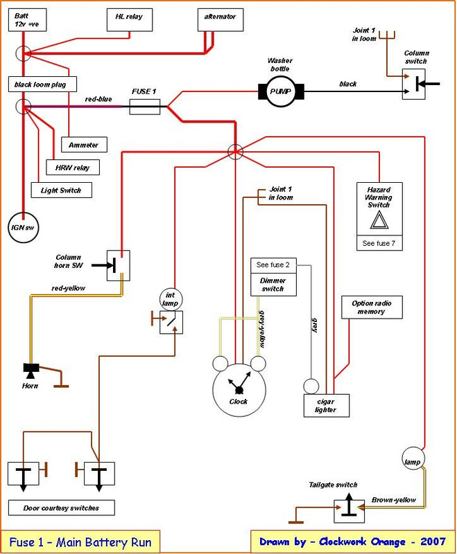

Danny, hope some of this helps. Thanks to Alan Brown on Capri Power.
FUSE 1 (16amp)- LIVE - power feed is heavy Red-Blue from cable joint in MAIN BATTERY Red wire to ignition switch, after loom plug
feeds out on heavy Red wire which goes to cable joint in loom, meets 6 wires --
a -- Heavy Red -- to horn column switch
b -- Red -- to rear loom and tailgate/boot lamp
c -- Red -- feed to interior (roof) lamp
d -- Red -- feed to clock
e -- Red -- feed to cigar lighter socket - and connector to radio memory
f -- Red -- feed to hazard warning light switch
and -- under bonnet - Red wire to washer bottle pump

Been trying to interpret the (unfathomable) circuit diagram in Haynes: so the supply for F1 is actually taken from the main batt supply to the ign switch, it`s spliced into that then? (not really a question - you even know the colors
If above is acurate and the F1 feed IS tapped off the live feed to Ign Switch, then if that connection was faulty it would have no effect on any of the other circuits as they are all switched and therefore come NOT from batt but from the switch (again, looking at the Haynes I can see why it looks that way
