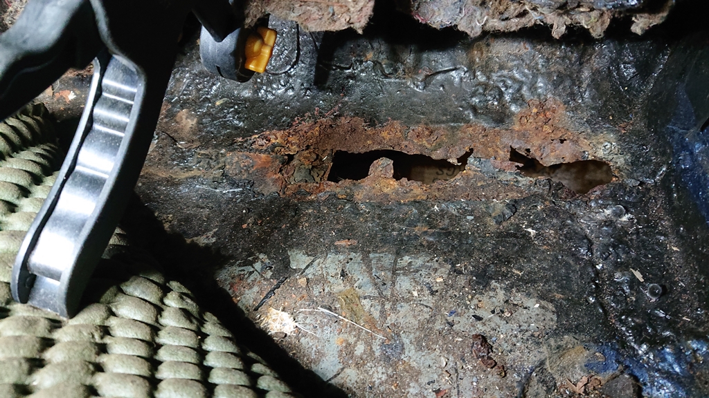

Post by Peter-S » Sun Feb 02, 2020 6:56 pm
Capri is booked in for MOT next Saturday.
Do you think I'll get away with this :(

Post by Jasonmarie » Sun Feb 02, 2020 9:02 pm
All is that the drivers side floor ? Peter

Post by D366Y » Mon Feb 03, 2020 9:07 am
It's not structural so it's fine! :lol:

Post by Paul G » Mon Feb 03, 2020 11:13 am
:agree: too. It's more than 30 cm from any structual mountings.
I don't envy you Peter having to scrape all that blackjack off to find clean metal to weld to.

Post by stevemarl » Mon Feb 03, 2020 4:28 pm
So, seriously, that would pass an MOT because it`s not within 30cm of whatever?

Post by D366Y » Mon Feb 03, 2020 5:16 pm
Pretty much - this is what the RAC website says about rust;
Sharp edges on the bodywork caused by corrosion or accident damage are not permitted, as they could injure pedestrians.
Rust is an MOT issue more generally, particularly for older cars. Excessive corrosion on safety-related parts, such as the steering and brakes, is a no-no, while rust within 30cm of these components may also result in a fail.
Could be rusted to buggery but apparently it's fine if it's not sharp and doesn't affect the structural integrity so that it folds in half?

Post by Bug » Mon Feb 03, 2020 6:20 pm
What about if it's within 30 cm of the brake pedal mounting?

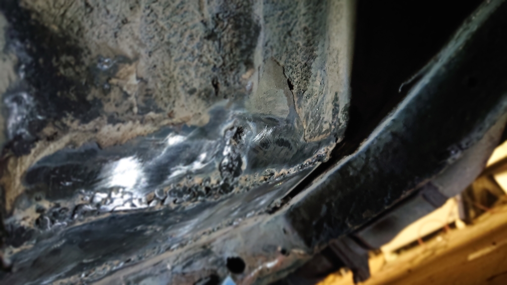

Posts: 6953
Re: Will they notice!
Post by Peter-S » Mon Feb 03, 2020 11:16 pm
Perhaps I should have left the hole to see what the mot man says! However, since it runs up to the sill which is structural and can't be much more than 30 cm from the seat runner front bolt I exercised a little pigeon poo welding repaired the grot.
Posts: 5277
Post by Fordoholic Nick » Tue Feb 04, 2020 1:56 am
Great job there Peter :applaud:

Posts: 6953
Post by Peter-S » Tue Feb 04, 2020 10:28 am
Cheers Nick. Certainly won't win any awards but should stop my feet getting wet :)
