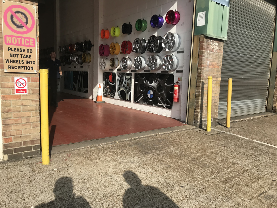

So I think you all know but after using a new product on the wheels it stripped the paint and made them look pants . Also thanks to all I got the new Center cap badges as well .
But I have dropped the car of today and the wheels are being made good again .
I will keep you all posted how they come out ...
I did asked the girls in the office if the radio could be put on classic FM plus if they could say good night to her every day .
Jason
Plenty of colours to choose from so I have gone with pink :lol: thought it would match my eyes also some member won a award at Dunton with a pink t shirt but peach did not work at Brooklands .

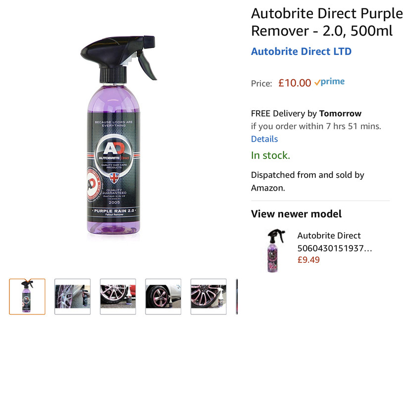

So yes what did I use I read in a car magazine about this purple iron remover and the review was good bringing old wheels back to there brightness but OMG it removed the paint and ripped the clear coat off . I was taking with Danny’s dad at The Ace and we could remove the paint on the wheels with our fingers . Really strange . I am guess they may have just been painted as After talking with Andrew the only way forward is getting done professional.
Peter I was hoping mick would do them for me :lol: who I think is still looking for a Capri ...
Here’s the stuff I used but don’t buy any .... :lol:

I have seen this sort of thing in action. My son who was a valeter used a different make on my Sierra and our Focus alloys, the crap it removes is incredible, it turns red and smells of sulphur.
Good job you didn't use it on your paintwork :doh:

I think a lot of these wheel cleaners are basically a mild acid. They are good at removing built-up brake dust but use them at your peril.
As said, it's best to get your wheels stripped and powdercoated, and then make sure you protect them with a few coats of the Poorboys (inside and outside faces) before you put the wheels back on.
Another tip I have picked up is to inspect the wheels regularly. If you spot any chips in the lacquer, treat them immediately to ensure that the damage doesn't spread.
