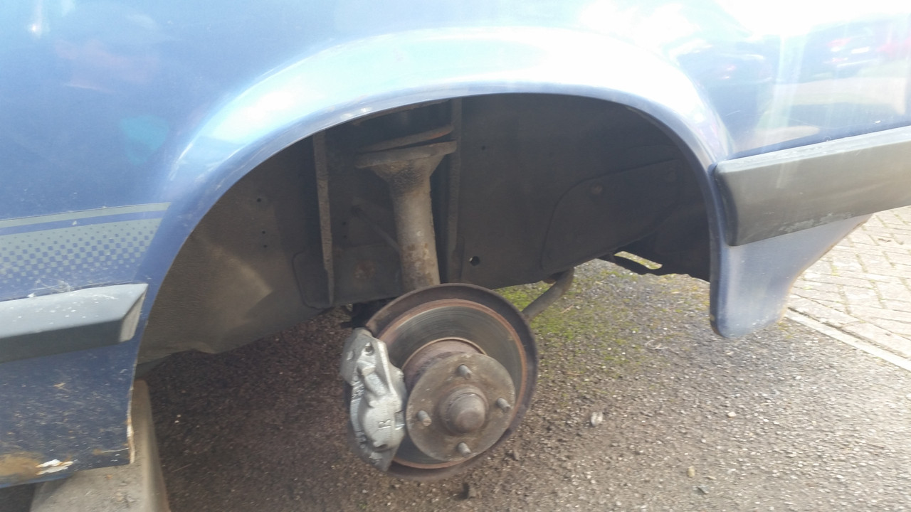

Little bit of time between paint coats and the F1 highlights today, so out with 'no name yet' and I figured I'd whip the wheels off and see what the underside of the wings etc looked like.
Receipts suggested new calipers in 2017 along with pads which seems to be the case. The discs are OK but have a hefty ridge, so on the cards for a change in the future.
Once I'd cleared half of the English countryside worth of mud from under the arch, the bottom of the A post doesn't look too bad, certainly in the realms of a repair panel
Looking forwards towards the front valance, and it looks like I'll only need to remove 1 bolt to get the wing off as it's held together with a mixture of fibreglass matting and old shopping bags!!

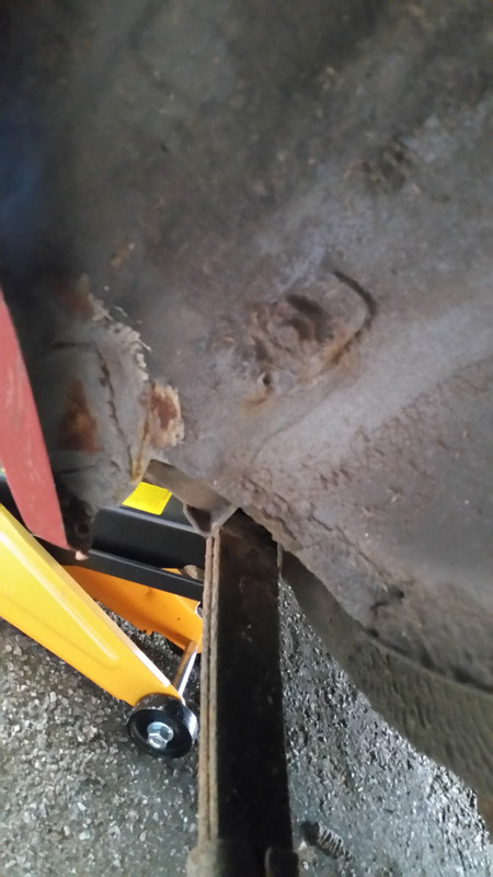

Both nearside and offside are very much the same, though the strap joining the inner and outer wings (as per 2nd pic above) is broken on the NS, any idea's where I can get one?

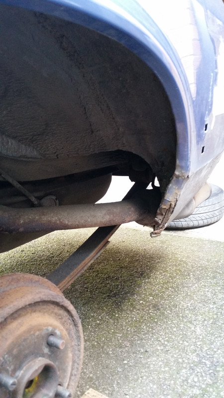

Moving to the rear, not all bad, the arches seem OK, will need lower rear repair panels I think
And finally, looking forward. The last 150mm or so of the sills looks to have been replaced, and there is evidence of a small repair

Cosmicbike wrote: the strap joining the inner and outer wings (as per 2nd pic above) is broken on the NS, any idea's where I can get one?
I'm sure that I've seen those on the CCI website, although I can't check as the site appears to be down.
I also found some more on Ebay:
https://www.ebay.co.uk/itm/Ford-Capri-M ... XQueRRYv7B
Edit: Thinking about it, it might be a better idea to ditch those brackets and fit the mudshields from the 2.8 instead. That will help keep the mud thrown up by the front wheels collecting inside the wing.

Thanks for the link, couldn't find them for looking! Mud sheilds are on the list, so if they replace the other bit then that saves me a few pennies.
