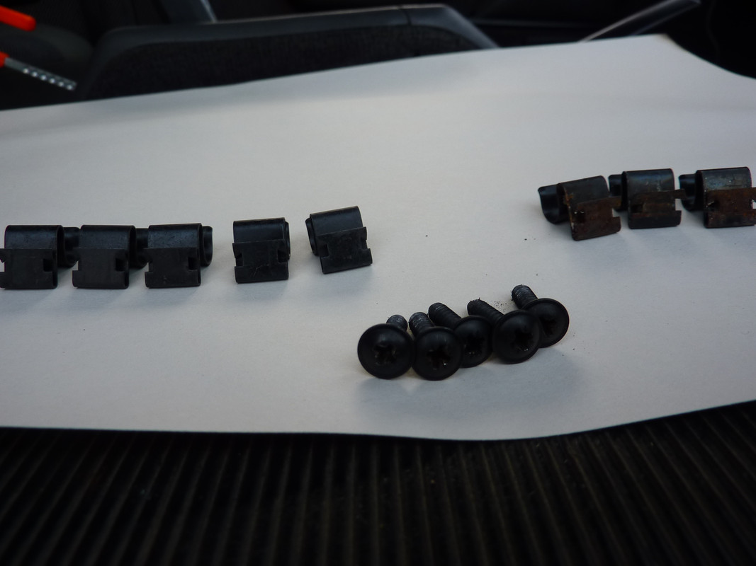

OK people - so the next flourish of work.
So these are the clips that go under the door sill trim and keep the loom tidily against the seam weld along the bottom door sill.
As you can see, the 3 clips on the right side are the best of the lot. In fact, of the 5 along each door ledge, 2 had completely disintegrated and 3 were OK, but had seen life. They sit there under the trim, in the damp and on wet days, probably a bit more moisture and just rot away.
So brand new clips and brand new screws. The screws fasten the plastic door ledge trim down. If I am tidying up the area, I might as well replace those screws.

And now to place them all on.
What I did was carefully prise off the old clips with a screwdriver. Then smother the new clip in grease, cover the weld seam where they grip also in grease, makes sure it grabs the loom properly and then push down on the clip onto the seam. The process is simple, just a bit fiddly as there is a lot of loom (especially the driver's side) to grab. I did actually have have to finish off by knocking the clip home with a wooden mallet. The new clips grip like a vice.
The same treatment for the passenger side. I cleaned the door sill trim piece, both sides and fastened down both with the new screws.
