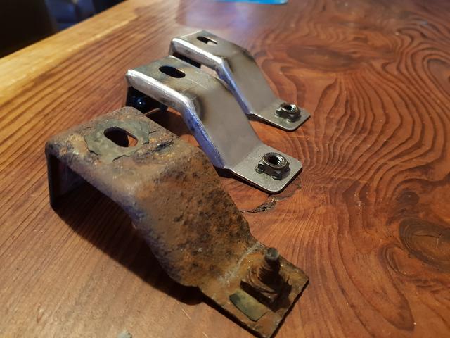

Got there in the end with the images. Well just a little update as foul weather stops play. Managed to get the bumper end brackets done and think they will look rather smart once painted up. Will continue on the small off car stuff over winter while I continue to try and negotiate a dry workshop for the body.
