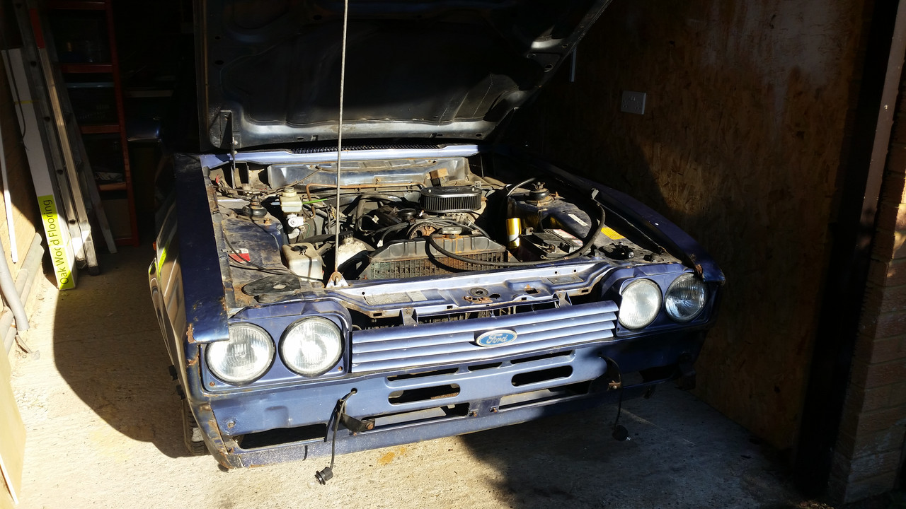

Otherwise, bumper off, one bracket remains stubborn and will need the bolt cutting. Metal panel in front of radiator also removed, so a couple of bits to paint if I get the time, after rust treatment.
