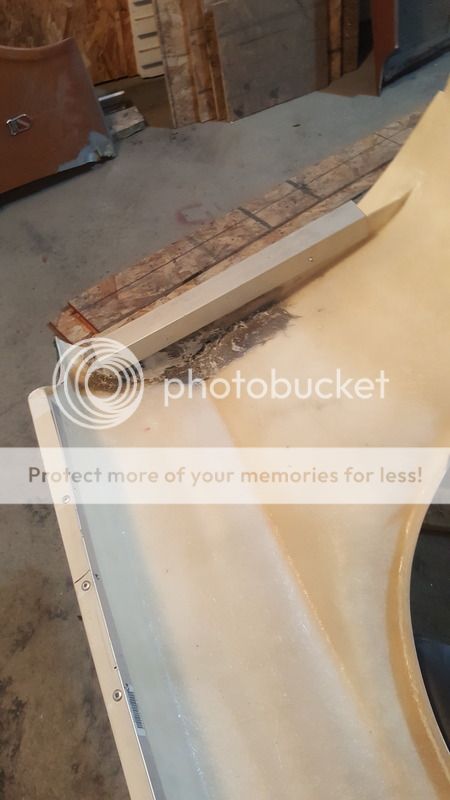

What happened with the fiberglass wings in the end?

I kinda lost heart in the wings for now and started on the drive train and suspension

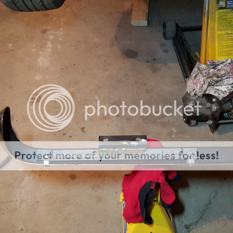

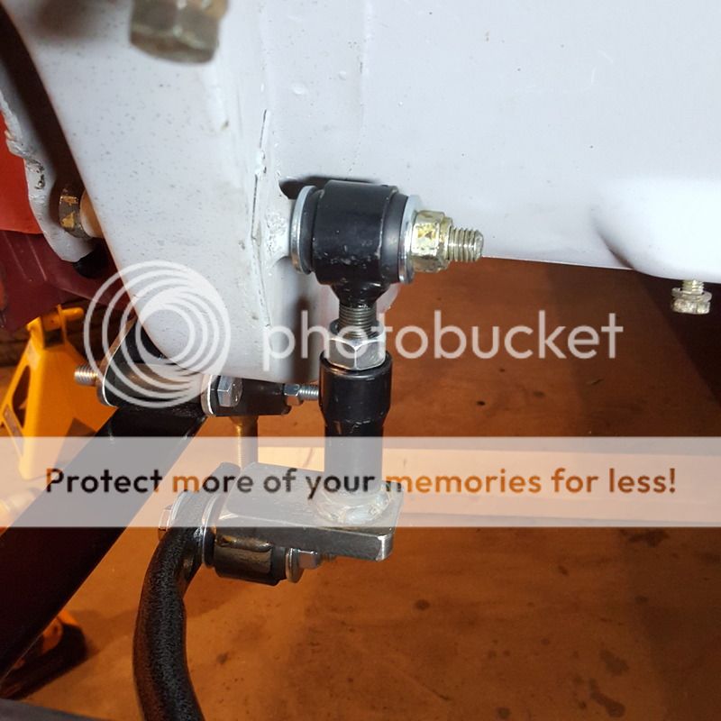

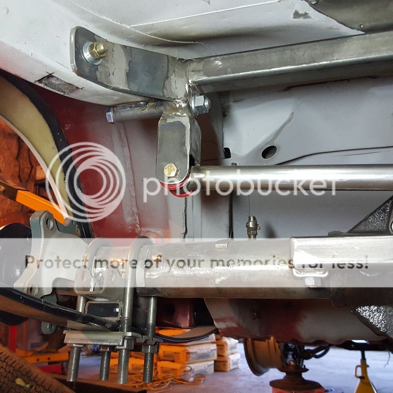

Got the watts linkage bolted on. All can be removed via a few bolts. Nothing welded in place except some small pieces of tube on the chassis to anchor bolts. Essentially nothing that can't be erased without a trace. Just in case I ever change my mind.
Also DIY'D some caltracs to stop axle twist under acceleration...
And a camaro rear arb mounted under the axle. The Camaro specific drop links wont work so I modified them to fit

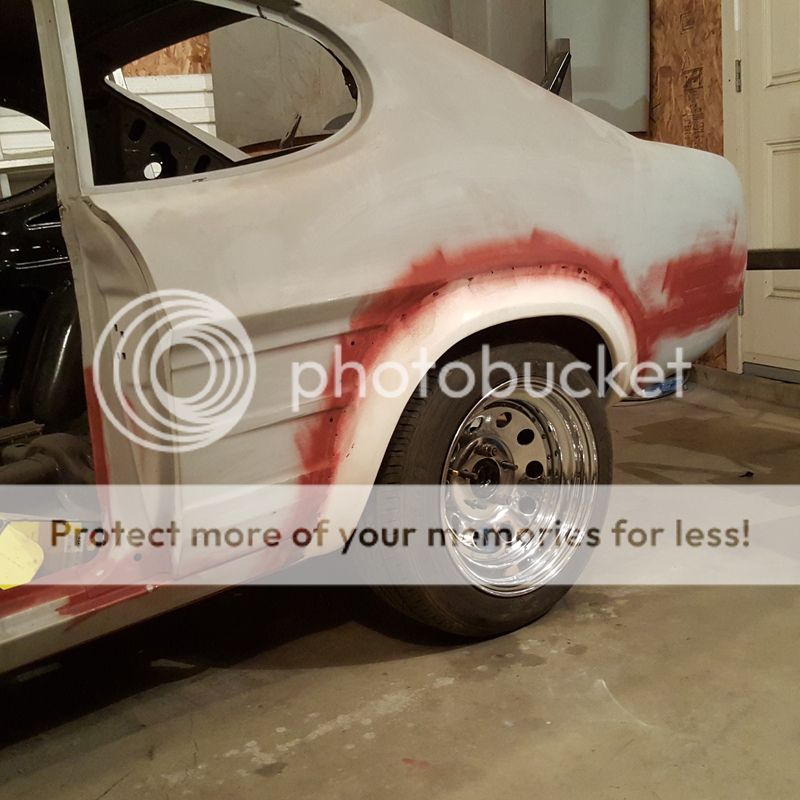

And got some rubber on to see how she sits..
Needs spaced out an inch or so on the back.
Now I know that it all fits without fowling I can do a final weld and add some extra braces and gussets to wherever needed.

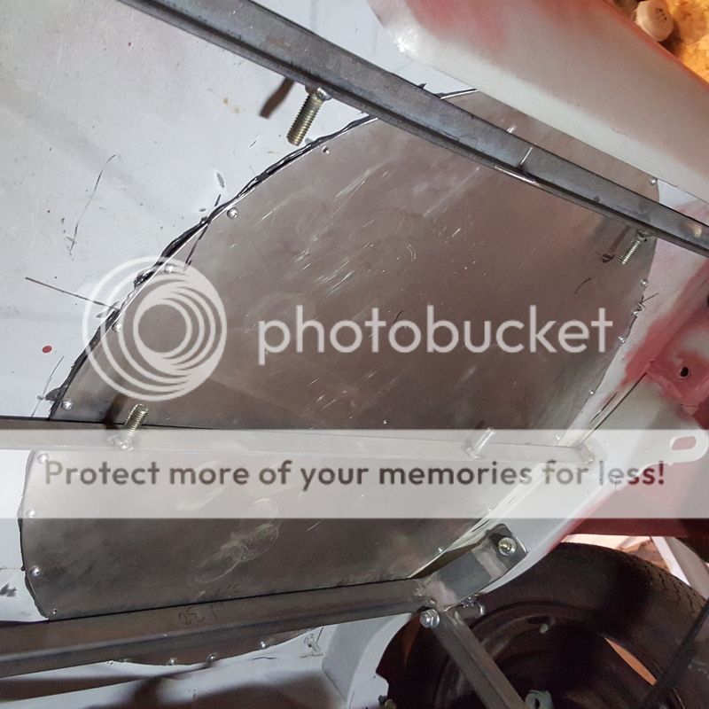

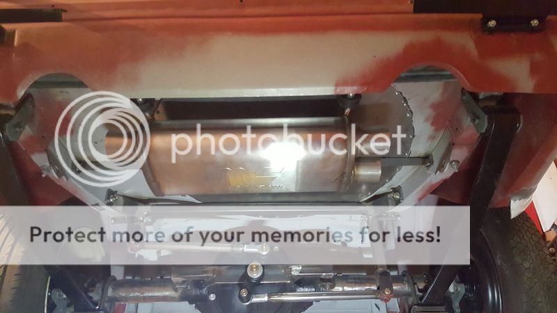

With the spare wheel well gone, plan is to run a 3" exhaust system and have something similar to this for Twin exhausts.

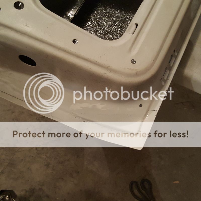

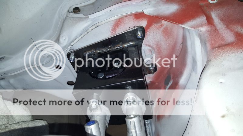

Post by Craigorypeck » Wed Jun 08, 2016 12:01 am
Bit of repair on the door
A bit of filler needed to smooth out , later tho
Some bracing underneath the spare wheel blanking plate
Exhaust with 3" inlet and 2 x 2.5" outs.
Bolted to bracing

Post by Will01 » Wed Jun 08, 2016 11:28 am
Some awesome looking work going on in this thread. Nice work.
Is that a Caltrac bar setup you are using with the leafs?
The watts link setup with removeable cross brace is what i am going for also, although my watts is a slightly different design.

Thanks will.
DIY'D caltrac torque arms. I just copied what they look like but the real deal have a solid aluminium front bush so there is absolutely no slop. I just using a poly bush which seems stiff enough but there are Racing bushes with higher shore poly that I could fit later, or get some alloy ones turned.
I'm gonna add an extra piece to the watts pivot area and have a few extra holes so the crank can be lowered if needed.

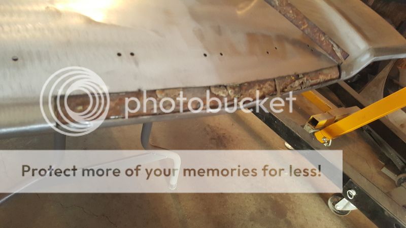

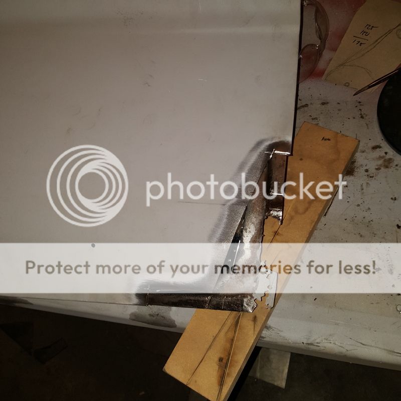

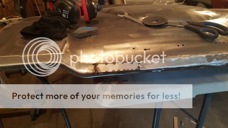

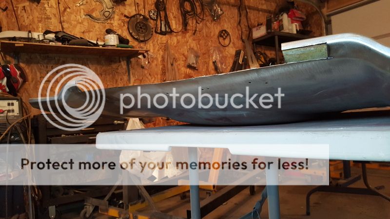

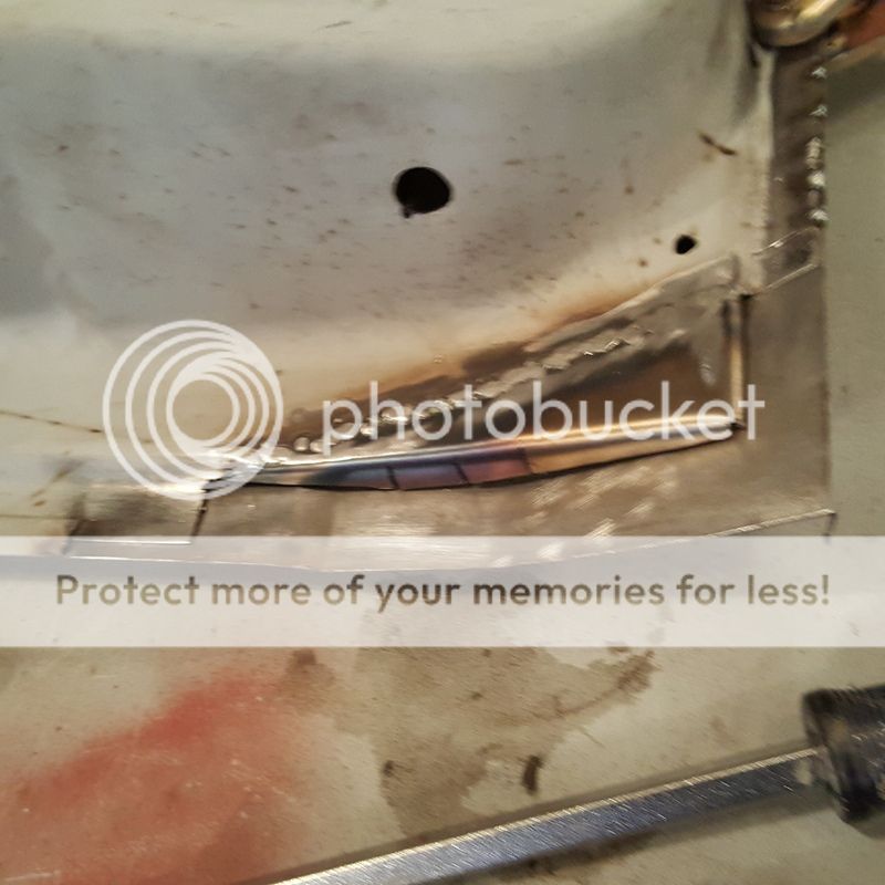

Post by Craigorypeck » Sat Jun 18, 2016 4:51 am

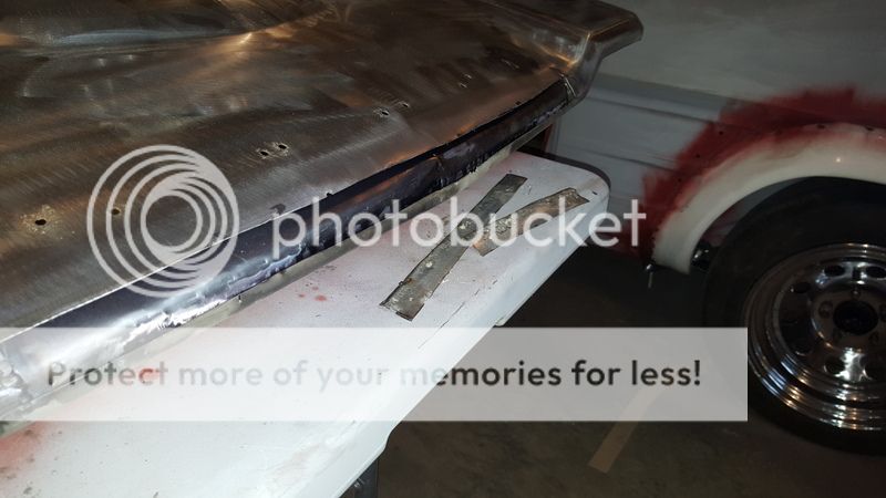

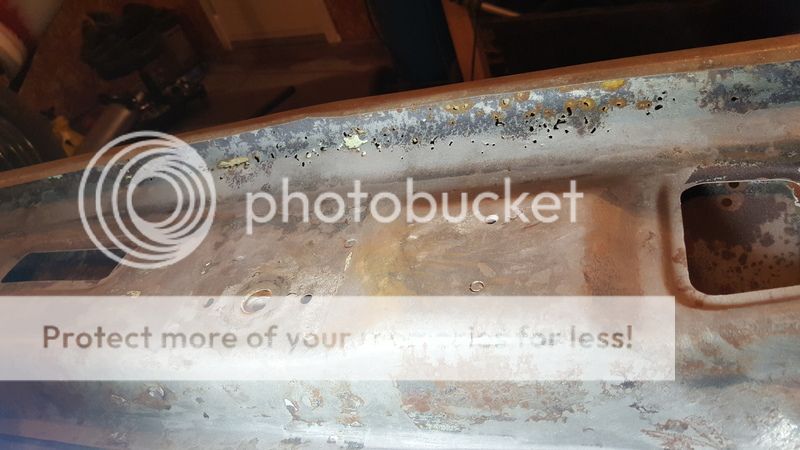

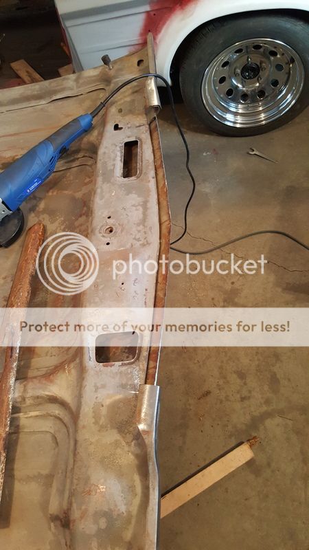

front edge of bonnet was looking a bit crap
as was the inside
work time
both inner and outer lips cut away
Fabrication time
this was one tedious repair but im well happy with it
And I found a spot for the first intercooler of my twincharged setup... i have the adjustable struts as low as they will go and the shock will bottom out before i get tyre contact.. either that or I put an aviary in there?
L O frickin L!!
:spam:

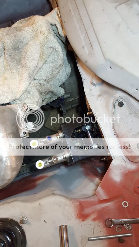

Fitted a bias box, not the easiest job as I had to get rid of the servo bracket it was supposed to be mounted to to gain some extra room. Mounted directly to firewall. Good n sturdy..

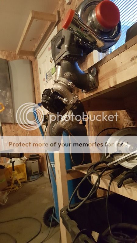

Done some pipeage for the turbo wastegate

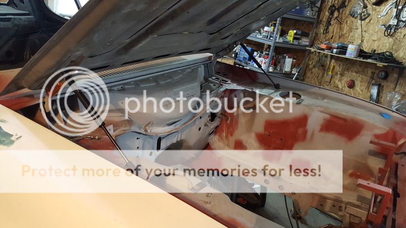

Engine mock up done
This is as far as Ive got before taking everything off and back on the spit for body work
..Image

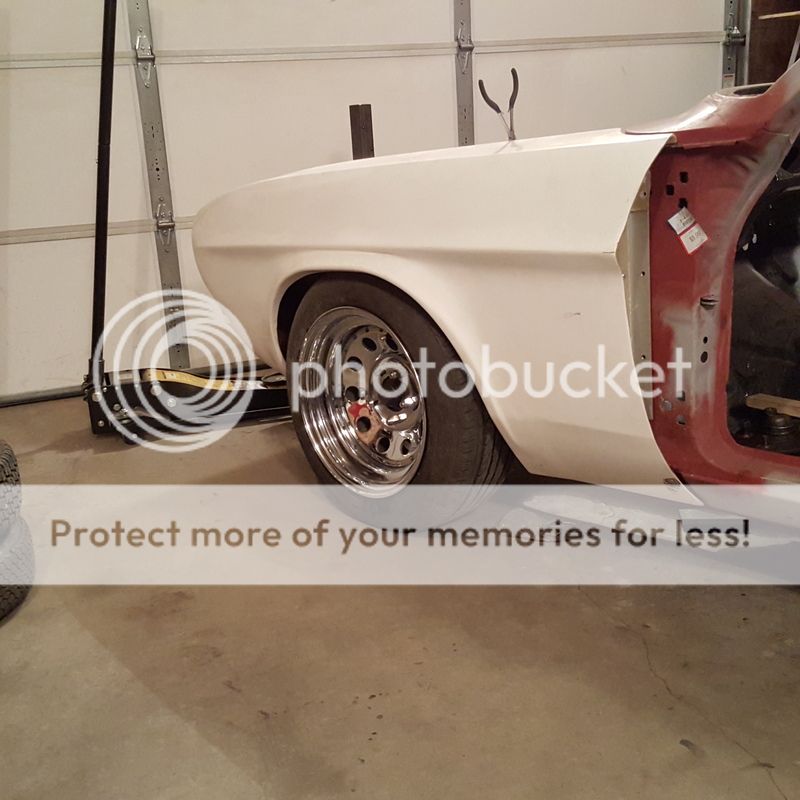

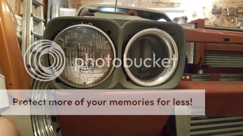

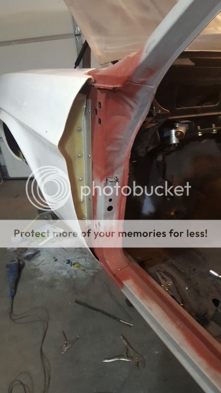

Had to get some struts on the bonnet as it was difficult to get wings and lights lined up with one hand and then trying to prop up the bonnet with the other
.Image

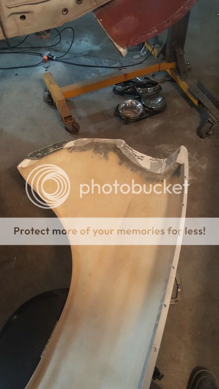

Fine tuning these shite wings
I plan to make them removable as I have the intercooler in the wing area.

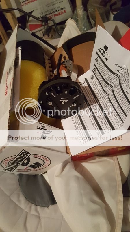

Got an intank efi pump conversion
And a stage 3 clutch

Nice work, moving on nicely :)
Inspired choice of intercooler location! GOing to be interesting to get a good bit of airflow to it there. Hav you considered running a water cooled intercooler?
Plans have changed to just make a good fun Track Car :)
