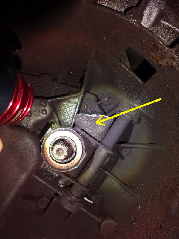

Oh, I know what that`s like - I got a Punto off my brother: wife got company car so surplus. Should have scrapped it but it`s quite a nice little car, and passed its MOT no advisories. After a week the starter went: strangely the `nose` was missing when we took it out, assumed it was broken when he`d had the clutch done in a garage years ago . Replaced that, next day got 1 mile down the road - clutch went (pedal stuck on floor then did come back, but slipping badly). Pissed off, shoved it in the garage and taxed the Uno . Sat for a couple of months as I couldn`t face it. When I eventually got round to it this is what I found:
You couldn`t make it up, the piece of starter had wedged behind the release arm so was holding the clutch partly depressed. Unbelievable! Still got to take `box off to sort it - which is a pain!
