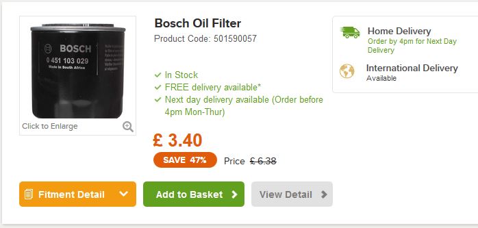

Post by pbar » Thu Dec 13, 2018 2:11 pm
For the oil filter, I've just bought two for a fiver (Bosch) at Euro Car Parts, as they had an offer on, all filters half price, so I'd look at that.
Otherwise go to Car Parts 4 Less, the Bosch ones are cheaper than the one in your list and free postage too.

pbar wrote:For the oil filter, I've just bought two for a fiver (Bosch) at Euro Car Parts, as they had an offer on, all filters half price, so I'd look at that.
Cheers Paul, I always forget about Carparts 4less, will order that now!
