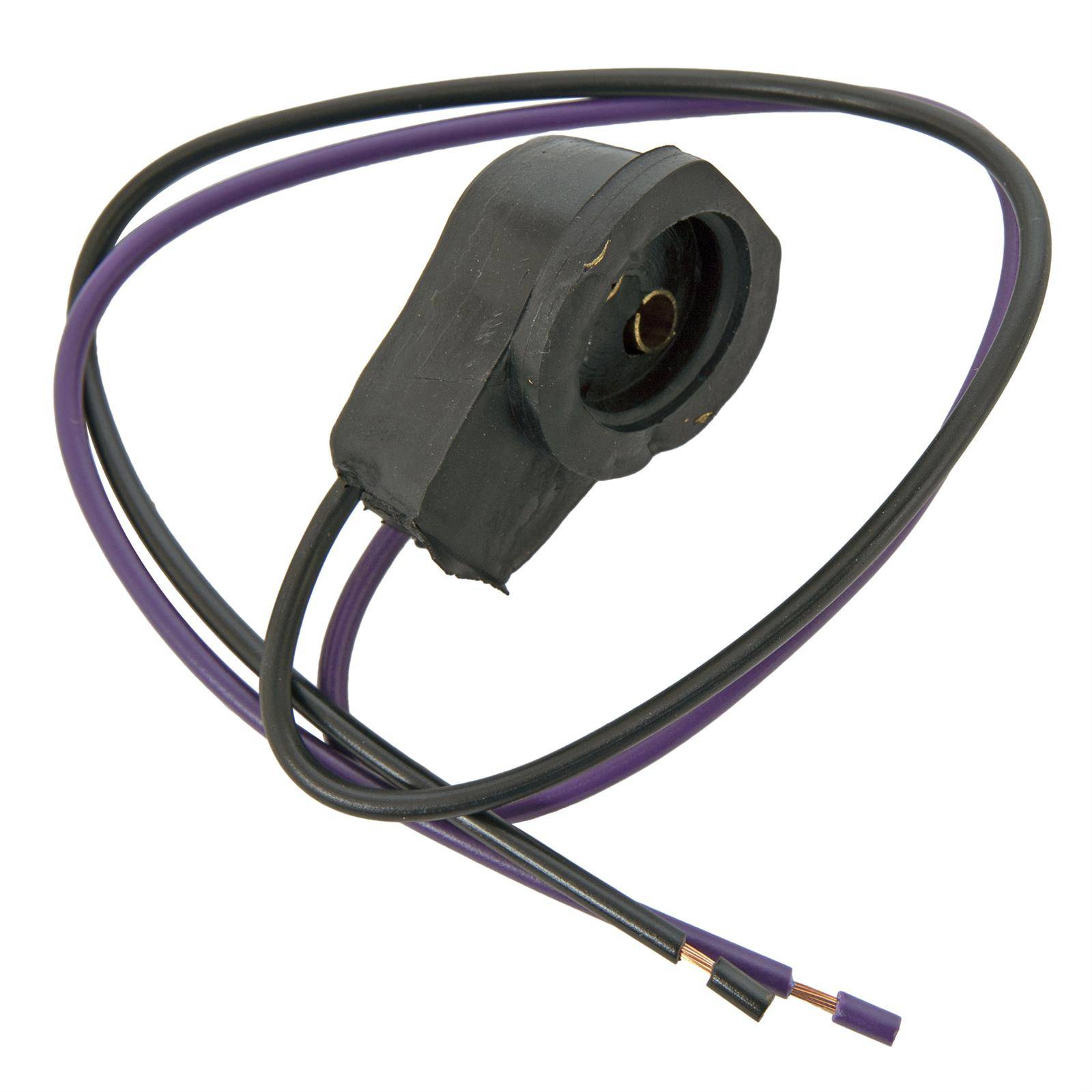

Has anyone got a picture of what the reverse light plug is supposed to look like? (At the gearbox end)
Looking at the replacement switches on ebay it looks like two ‘prongs’ stick out the back, but when I look at my plug there is just a small spring in the middle, and looks too shallow. Is this correct? Can’t see how this would connect to the replacement switch to be honest.

I changed mine some time ago, looks like the pic below. I think different gearboxes had different switches and therefore different connectors, might be a clue as to why your current connector might not match?

Sorry my misunderstanding. Think it's something similar to this.

Strange, mine looks like that from the outside but in the middle just has a small spring in the centre. I’m starting to think that the bottom of the switch is stuck inside the plug/ connector.
Just out of Curiosity what are those connectors called? Just in case I have to end up buying one.

You`re absolutely right! When I pulled my `plug` off the switch I couldn`t work out how it went back. It was as yiu suspect, the top plastic section of the switch (which is only held by the metal being crimped) had come off with the plug. If you`re lucky you may be able to salvage. There should be a metal disc about 1cm D which sits beneath the spring and effects a contact, this may have dropped out.EightyFive wrote: ↑Wed Sep 29, 2021 9:08 pm ’m starting to think that the bottom of the switch is stuck inside the plug/ connector.
" what are those connectors called?" Reverse switch plugs for Capris I guess, AFAIK they are specific to Ford? THe connector will be OK, if you need anything it will be a new switch assy.

Phew. I’ll dig the remains of the old assembly out of the connector and fit a new switch. Feel like I bit of an idiot now but atleast it’s a straight forward fix!stevemarl wrote: ↑Wed Sep 29, 2021 9:33 pmYou`re absolutely right! When I pulled my `plug` off the switch I couldn`t work out how it went back. It was as yiu suspect, the top plastic section of the switch (which is only held by the metal being crimped) had come off with the plug. If you`re lucky you may be able to salvage. There should be a metal disc about 1cm D which sits beneath the spring and effects a contact, this may have dropped out.EightyFive wrote: ↑Wed Sep 29, 2021 9:08 pm ’m starting to think that the bottom of the switch is stuck inside the plug/ connector.

Cheers, you're welcome If you did need another connector let me know, I'm sure I can find the seller of the one in the pic, you can ask them for the sizes of the terminals etc. to see if it would fit, alternatively might be better to ask Martin first at CapriGear if he has one.
