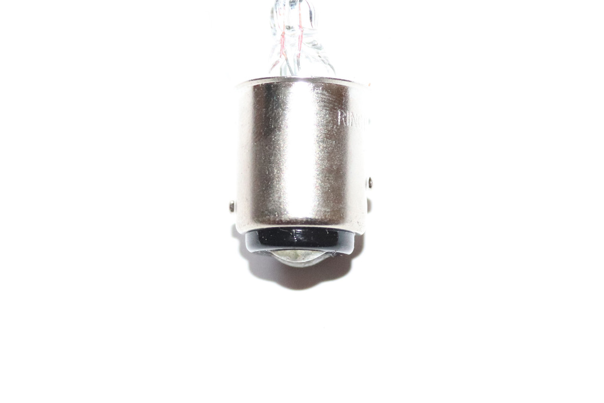

I'm sure you knew that, on a double-filament bulb on a Capri and any other car of this era, the locating pins are diametrically opposite but are at different lengths from the contact face, as in the photo.
A couple of months ago I discovered that on my Mondeo (Don't laugh!) when I tried to replace a brake light bulb the pins are not only different lengths from the contact face they are not diametrically opposite but off-set around its circumference. At first glance this minor difference is not immediately apparent.
I managed to get an older bulb into the Mondeo housing but it obviously didn't work as it should. :headscratch:
Then someone told me about the difference. :doh:
Have you tried to use a later type bulb? (Just asking.)
