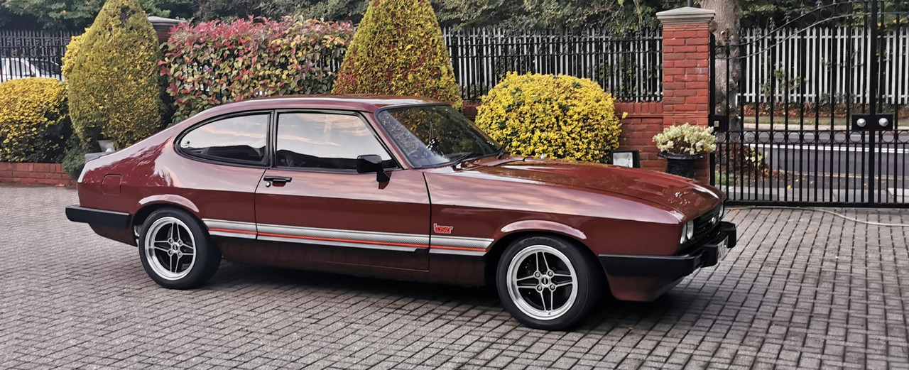

So the new alloys are on... The tyre fitters think I need longer bolts..... Is that easy to do and where can I get some...
- Posts: 2576
Re: Alloy Wheels
easy enough to change - wheels off, hub off, gently prise (with a large hammer) the old studs out, then gently (again, twat with a hammer) the new ones in the back of the hub.Mrbaboon1985 wrote: ↑Thu Nov 05, 2020 10:40 am So the new alloys are on... The tyre fitters think I need longer bolts..... Is that easy to do and where can I get some...
Not sure where to purchase them from mind as never changed them
Re: Alloy Wheels
The studs are splined and pull in tight to the hubs. You can of course 'twat them with a hammer' but another method which also works is to use a wheel nut to pull them on.D366Y wrote: ↑Thu Nov 05, 2020 1:12 pmeasy enough to change - wheels off, hub off, gently prise (with a large hammer) the old studs out, then gently (again, twat with a hammer) the new ones in the back of the hub.Mrbaboon1985 wrote: ↑Thu Nov 05, 2020 10:40 am So the new alloys are on... The tyre fitters think I need longer bolts..... Is that easy to do and where can I get some...
If your wheel nuts have enclosed ends they won't go tight enough, but you can pack out the stud with washers, or a socket, or use an old standard wheel nut.
I assume as you've got as far as fitting them that the nuts are the correct shape to snugly fit the holes in the wheel? Some are chamfered and others are flat, and they should have a captive washer that is free to rotate, so the nut doesn't cut into the alloy.

There on just the tyre place think longer studs would be better to secure them!
- Posts: 2576
Re: Alloy Wheels
I think I heard somewhere once that it's recommended to have 7turns on the nut or something? If that's correct and you have that many turns I'd leave it as is?Mrbaboon1985 wrote: ↑Thu Nov 05, 2020 1:34 pm There on just the tyre place think longer studs would be better to secure them!
