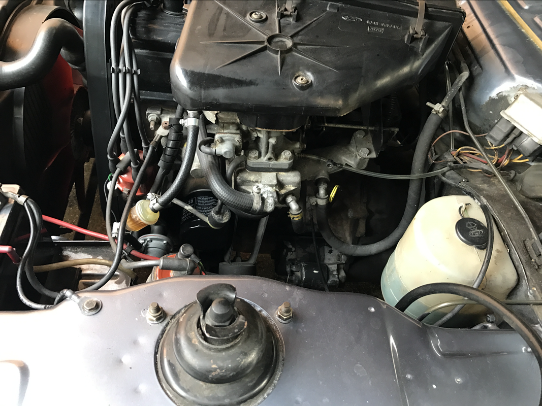

Here’s a old picture of mine dan if it helps .

The only two hoses that you will have to change/get are the hose from the heater matrix up to where the auto-choke would be and then the one from the auto choke down to the inlet manifold. You will have to use a joiner piece between these two hoses which will sit behind the carb. I doubt anyone makes a single piece hose as the Capris were designed to have the two hoses.

Jasonmarie wrote: Wed May 13, 2020 6:22 pm Here’s a old picture of mine dan if it helps .
Cheers Jason, is that a manual choke on yours? If so can you please take the air box off and show me where your join is??

Thanks Paul, I did think this would be the case, I got a Samco hose set a while back but think I got an auto choke set rather than manual choke - just trying to figure out what set I should be buying to make sure I get it right basically! I have a joining section at the moment from the pipe from the heater matrix pipe that reaches to around the corner of the carb manifold and there's a join there that takes it around to the back of the carb manifold, just wanted to check that was correct really!
If your 2.0S is easy for you to get to I'd appreciate you taking a picture but if it's not sat on the drive don't worry.

Dan no mate it’s auto choke on mine . Nick has a manual choke now with them 45s .

Dan, all you need to do it link the 2 existing pipe that come from the bulkhead to the auto choke then from the choke to the manifold . i don't believe that they make a pipe for this in one section

Arnoldhar wrote: Thu May 14, 2020 10:05 am Dan, all you need to do it link the 2 existing pipe that come from the bulkhead to the auto choke then from the choke to the manifold . i don't believe that they make a pipe for this in one section
Thanks, I did think so, mine are just bent and twisted all over the place so wanted a rough idea of what a normal one is meant to look like!
