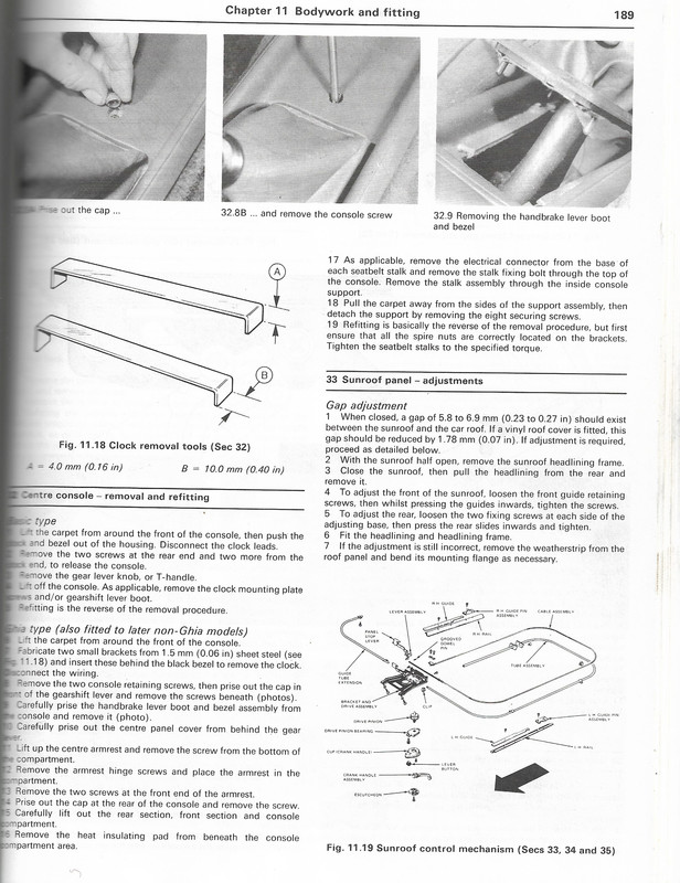

I'm just wondering if anyone has any advice on how to adjust a sunroof properly mine is not closing and sealing great

Post by Andrew 2.8i » Sat Feb 29, 2020 8:01 am
Have you changed your mind about fitting an aftermarket pop-up sunroof?
An adjustment procedure is described in the Haynes manual.

Yes they did mine twice first time was a tube that is at the back fell down , then it Was the Handel was lose and stopped me from closing the roof .
