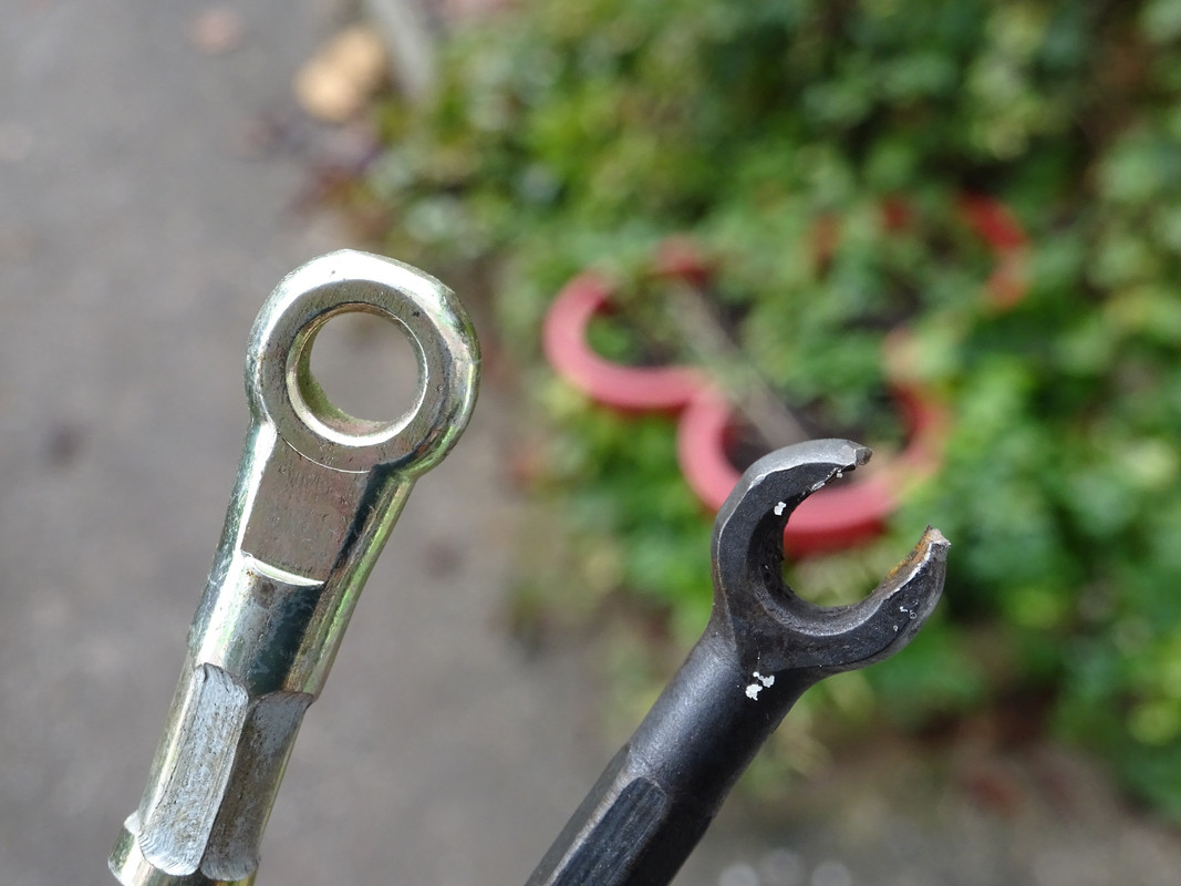

Just thought it worth pointing out that the clutch cable , where it locates onto the pedal, is often forgotten but will benefit from a drop of oil every decade or so. Otherwise this can happen, with no warning, and could potentially leave you stranded. (Fiat cable, but same principle applies):

Wouldn't leave you stranded, the car can be driven without the clutch .

Yes, I know, and I drove it home - I just thought people might prefer to avoid being in that situation in the first place that`s all. You`re quite right though it`s really no problem.

It's easy enough when the car is on the move, but it's a bit of a pain if you are in stop-start traffic.

Thanks! There`s also the possibility that the cable could snap while you`re sat in a queue with the clutch depressed - dropping the clutch and ramming the car in front.
