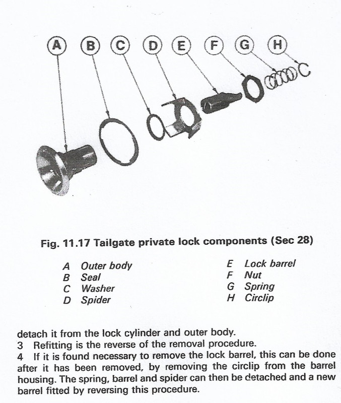

I found this in the Haynes manual, if it helps.
Or is that the stage you're already at?

It looks like you are at the stage where you need to remove the circlip.
The lock assembly on our car was disassembled to the point as in the diagram provided by Andrew.

You’ll see on the diagram the washer – item C.
I replaced this with a suitable thin O-ring.
Since the final lubrication and fitting of the lock assembly it has been OK.

Thanks for the replies and Andrew thanks for the picture from Haynes - I'm at that stage currently and what I'm at now is part E on your picture (the lock barrel) is separate from everything else bit of like to get at the tumblers in the same way you can with the door locks but currently for the life of me I can't figure out how to get the black cover off of the tumblers section
