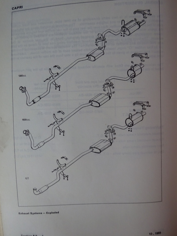

The pipe still had to go over the axle though, that looks like a foot of straight pipe, can`t see how that would work? Unless it`s taken from exactly above and there IS a big hump in the pipe that`s just not visible due to the angle?
Edit: This is from the Official Ford workshop manual for Mk1, I would say they were still different?
Posts: 6944
Re: NOS Exhausts
Post by andyd » Fri Oct 04, 2019 4:26 pm
You are right Steve looks completely different.
