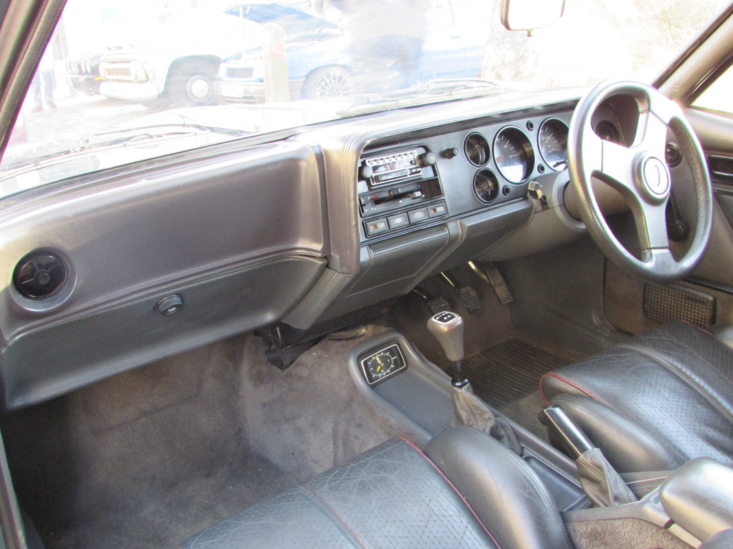

Here is "my" attempt, as fitted to Mark's (now Lee's) 280. It's a credit to Mark's handiwork!

I've altered the design so that now there's just a narrow support that covers the section between the holes. It's not blocking any of the holes underneath now.
I've put most of it back together today and just have the glove box to put back. I think my back has had enough for today! (not as flexible as I was 20+ yrs ago).

Re: Replacement dash
Finished installing the glovebox, lower mid/drivers side trim, steering column shroud and the fragile black plastic pedal assembly trim.
Thankfully, everything has gone back together as it should although the heated rear window wasn't working/amber switch light not showing when on. After checking the bulb/connection/wires, the culprit turned out to be the fuse on the relay. All sorted now.
