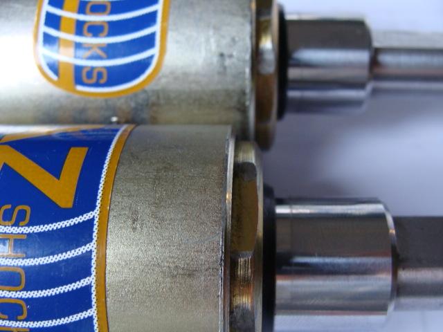

Does anyone have any experience with Gaz adjustable shocks on their Capri ? I bought some GAI 4130 strut inserts for the front end of my Capri and I have a query about the adjustor . I bought these of Burton's ( along with 3 grands worth of stuff for Capri ) and when they arrived it was immediately apparent that someone had at least tried to disassemble them as the apex on the flats of the large nut/seal assy were rounded off,after a bit of communication with Burton's who refused to acknowledge the damage to the nuts despite being supplied with good detailed pix clearly showing the damage invited me to send them back at my expense ,and said that if they thought they were ok ,would not return them unless I paid for that too.
The main issue is that the blurb claimed there was 36 position adjustability where as mine are stiff ( so much so that the supplied plastic knob is only just up to the task of turning the adjuster ) and have no click/positions . It doesn actually say that there are "click" positions but one would assume there being 36 positions you would be able to feel them. When I asked Burton's about this I was told that he (the person I was in email contact with) didn't know and couldn't find out , he then referred me to Ralley Design and said I should ask them ( who had nothing what so ever with this dilemma ). Any how ,does anyone out there have any experience with these strut inserts , do they have detectable click positions or is the stiff
positionless adjustment normal. For what it's worth I cannot detect any difference from one end of the adjustment to the other.
I have an arsey feeling that someone has taken advantage of the fact that I'm on the other side of the world and sent me the duff ones, and the fact that Burton's were so indifferent only backs that up. Anyone able to put my mind at ease or confirm my fears?

Just to follow up, I wrote again grizzly email to Burton's (Keith Turner ) with a few pix ,he forwarded it to the Gaz people who said that ( da da da De da )they appear to have been damaged upon assembly (ooooh,hand assembled...I thought I could smell quality :wank: :xd: )and as for the click adjustment....they deleted that some 10 years ago as it caused some issues with peeps not detecting the clicks and over cranking the adjuster and thusly damaging the insert. So it would appear that all is indeed well ,so , thanks to Keith and Burton's for sorting that.....no coincidence that the 2019 Burton's catalogue turned up in the mail yesterday........kid in a lolly shop :lol:

Ah ,no , they ain't replacing them, apparently this is acceptable ,and if the only issue is a bit of nut damage,assuming they actually work properly , I couldn't be arsed sending them back. The apex's of the nuts are machined off a bit so they can fit under the retainer and the damage is minimal , just that it indicated to me that some penis fingered dullboot had been in there (possibly in an unsuccessful attempt to rectify the damage done by over tightening the adjuster and jamming it as per the warning In the inst , I initially believed this to be so because of the missing clicks ). According to the Gaz man adjustment is by counting 1/4 rotations of the adjuster , which is easy enough. The only thing bugging me now is that there is more damage to the nuts in the undoing direction than the tightening direction ( how do I post a pic , or I could pm you my email and you could respond to that if your keen for a look )

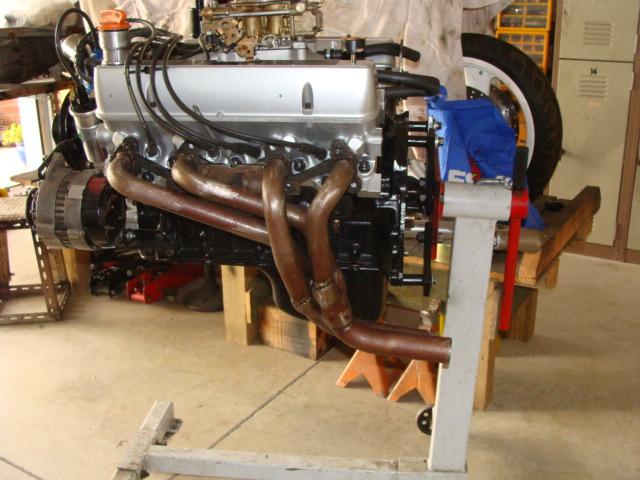

Thanks for emailing these pics to me to post on here for others to see. Yep you can deffo see where someone has had a go at those Gaz shocks mate but thankfully you say they are still perfectly useable to save you all the hassle. Glad all seems ok fella.

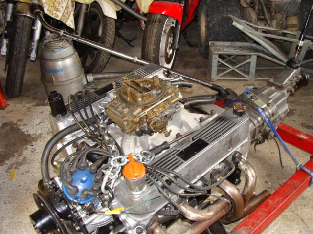

Now....onto the matter of the Rover V8 you are fitting. Wow !! Thanks for the pics. Looks stunning. Gonna be amazing fella....
Thanks for the pic of your Capri too Hamish. Looks lovely mate. Nice one.
Anyhow thanks for agreeing for me to post these pics for others to see. Its hard to believe that V8 will fit !! :lol: Great stuff :)
All the best mate
PS Keep us posted on this very exciting project
