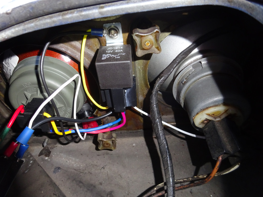

Hi, is there an easy way to get both twin lamps on dip and both twin lamps on full? I never understood why cars have twin lamps and just have a single set on at any one function.
I heard that it can be done with a relay and some extra wiring, and maybe different “dual function “ bulbs, preferably the brightest...I would like to get these parts, any info greatly appreciated...

The construction and use regulations specify only 2 dipped beams, but up to 6 mains (depending on vehicle width) which is why Jags, Stags, Interceptors and Capris - none of them ever came with 4 dips, but could have all 4 beams on.
http://www.legislation.gov.uk/uksi/1989/1796/made
SCHEDULE 4
PART I Requirements relating to obligatory dipped-beam headlamps and to optional dipped-beam headlamps to the extent specified in part ii
1. Number–
(a) Any vehicle not covered by sub-paragraph (b), (c), (d) or (e) Two
If you have H4 outers, https://www.ebay.co.uk/itm/HELLA-1L3002 ... 2749.l2649
it`s quite easy to get all 4 beams on. If you switch to beam, the dipped lamp stays on, so it`s just a matter of fitting a relay so that main beam switches over the supply from the dipped filament to the Beam filament (in the H4 outer bulb). Minimal rewiring, original fuses still protect and it fits neatly between lamps.
