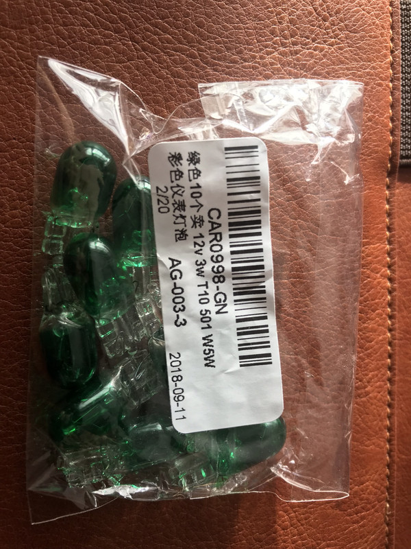

So at long last the boat landed from China and I have the 3w bulbs I will have to make this a winter job and try and do a with the old bulbs and with the new . Still waiting on my glass clock tubes from China . Just hope it never come over on the titanic ? :lol:
Will update early 2019 ....... or only 63 days to go and it’s xmas .
Off note I think the world wants a ticking clock for the mantle piece it’s crazy demand is higher then supply . :banghead:
Pictures of 3w bulb .

I was wondering how you were getting on with this Jason. I think it would be the only option I would opt for, those blue covers won't less forever, so simply removing them, having standard wattage tinted bulbs, and a still working dimmer tick all the boxes for me.

Yes will give it a go and leave for a least a good few hours to see what they heat up to .

Jasonmarie wrote:Yes will give it a go and leave for a least a good few hours to see what they heat up to .
Those 3W bulbs shouldn't be too hot as that's the same power bulbs as originally fitted.
