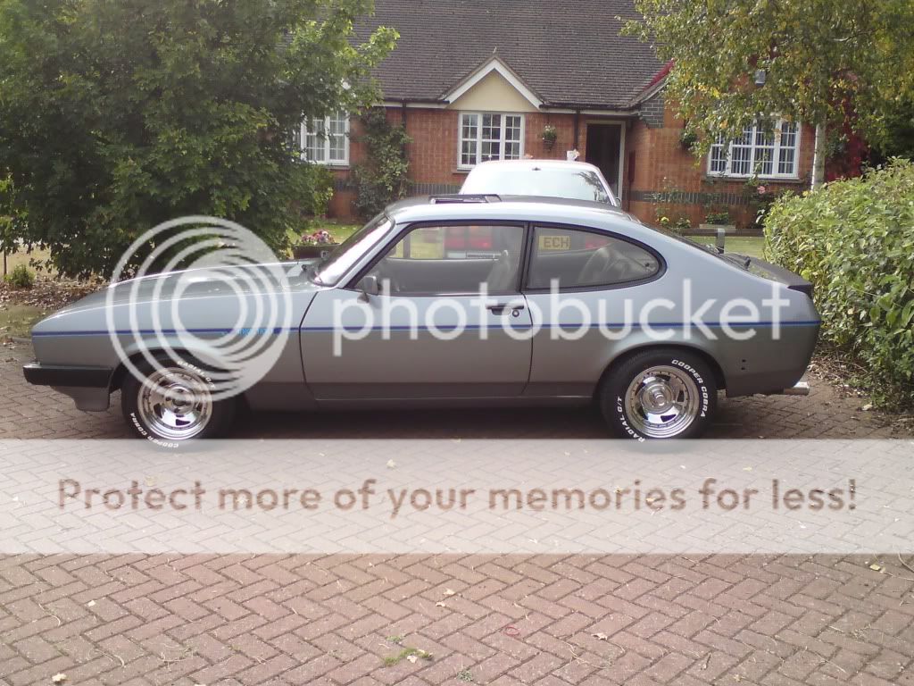

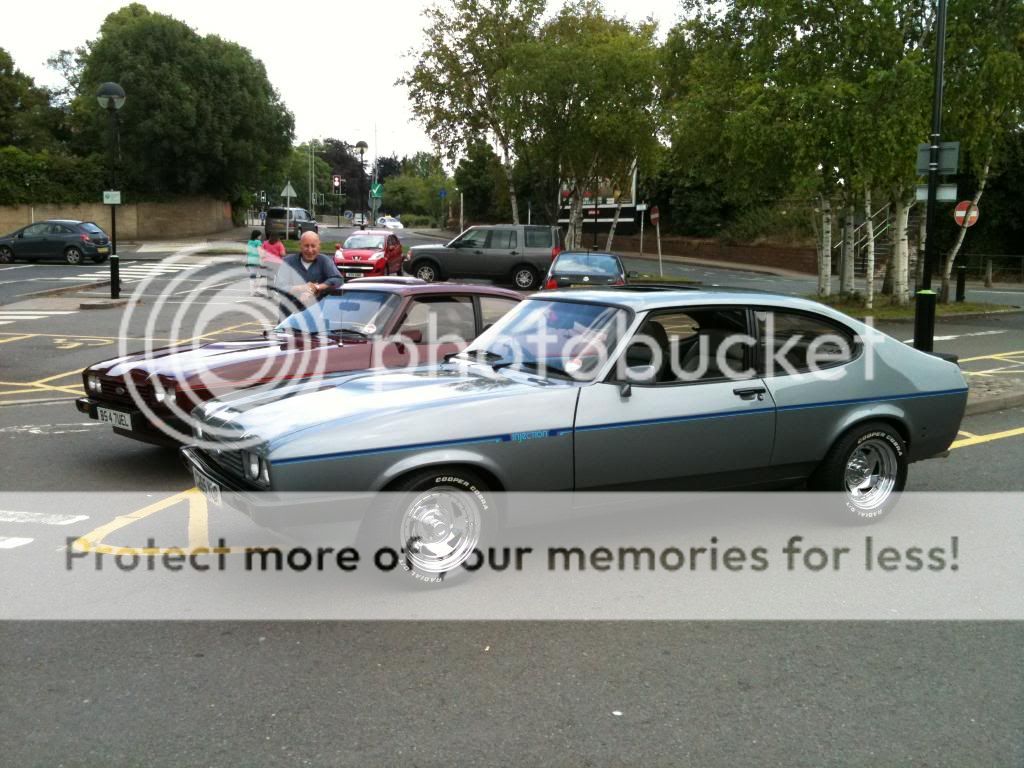

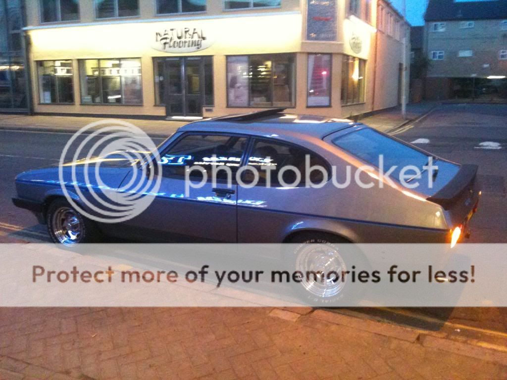

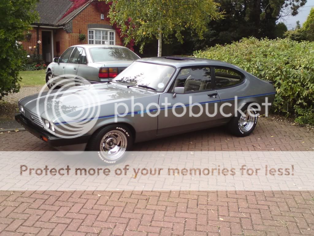

Not sure whether it's any help but I've just put a set of these Outlaw 2's on a Mark 3 and they fit absolutely perfect, imported them in from the states, as for Cragar wheels I've never seen a set for a four stud Ford, of course the next best thing would be Appliance 4 spokes but sadly they are super rare now and worth a lot of money considering they seemed to be 2 a penny in early eighties

Mr B wrote:
Mon Dec 30, 2019 6:04 pm
You have now.... :D
As seen on markthetart's car.
