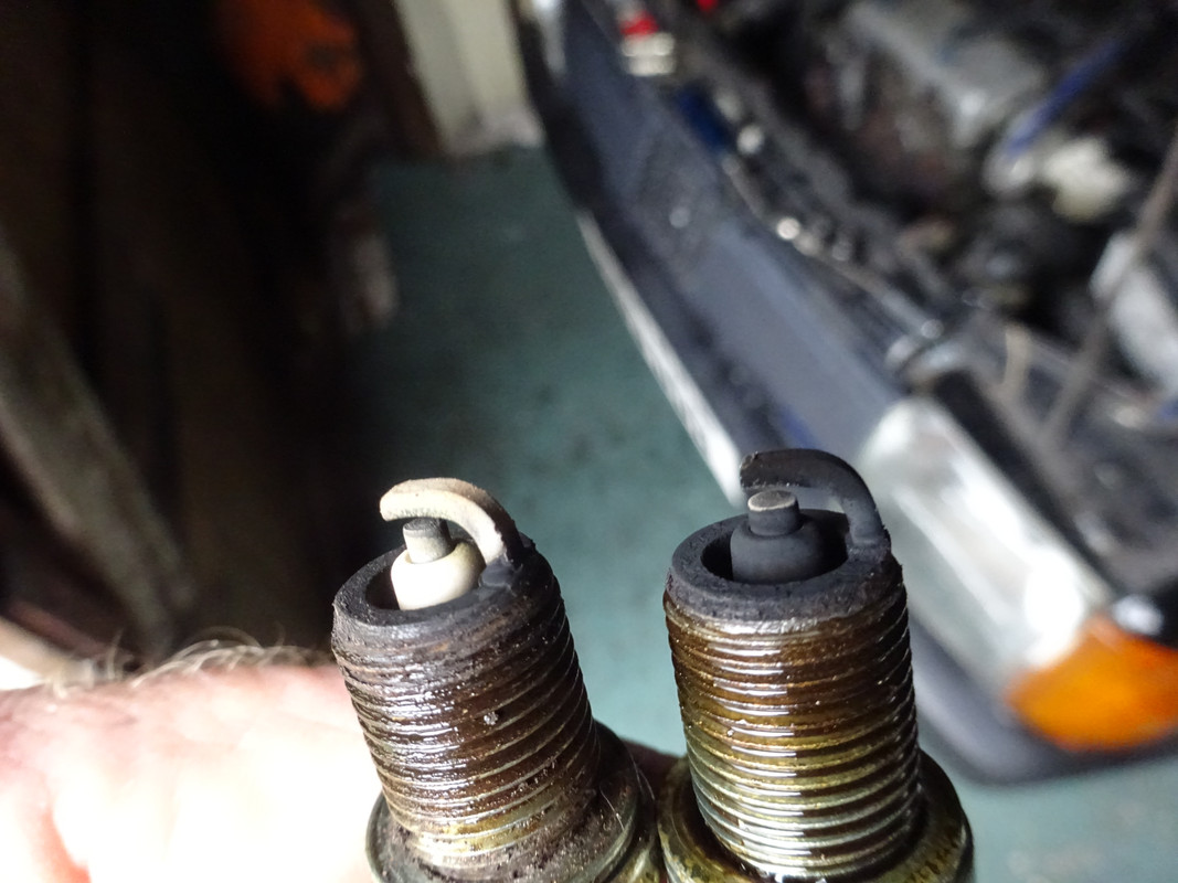

Just wondering if anyone has any ideas why I would havr 3 plugs which are spot on and one, No4, which is totally sooted up? Not capri but same idea, single carb into manifold, 4 equal length inlet branches. Runs perfectly, no visible smoke. (The LH one looks whiter in pic, it`s actually correct pale coffee colour)

I know the Haynes has pictures of different spark plugs and what different colours mean, in the meantime I found this link which will hopefully be of help - https://e3sparkplugs.com/blog/are-your- ... something/
To save you clicking, here's what it says about the plug you've described;
A black, feathery carbon deposit on your spark plugs can be an indication of a weak spark or an overly rich fuel mixture. Causes may include a stuck choke, misadjusted or heavy carburetor float, a leaky injector or carburetor needle valve, low coil output or high resistance in your spark plug wires.
If it's only one I'd only guess that maybe the spark isn't strong enough, maybe a dodgy lead and/or plug?

The centre electrode on the blackened plug looks to be shorter and the gap wider than on the "normal" plug. I'd try a new set of properly gapped plugs before condemning anything else.
If the new plugs don't do the trick then look into new leads, doing a compression test on the engine or looking for an air leak on the inlet manifold around the affected cylinder.

Just to clarify, the first 3 plugs were spot on the correct beigey colour, the 4th is absolutely black with soot. Very observant Paul - you`re right, when I came to check the gap it was way, WAY wider then spec (all the others had hardly any erosion at all; they were all new and correctly gapped 6k ago at last service along with new leads.) Just weird, I`ve never known one plug be SO badly fouled. I have now put a new cap and rotor in, as the old one was q bit grubby and it is the only other thing that could be causing misfire. Strangely, it was running great. Suppose I might as well do a comp. test while they`re out, hope to God it`s not a crack in manifold, although that would weaken one cylinder wouldn`t it? or could it be over- compensating for a leak elsewhere?

A cracked manifold ? Must be Sherlock's day off :roll: :xd: A cold comp test is great for finding out how things are when the engine is cold :) but you really need to do it hot. As a rule (there are exceptions )if you have only one pot acting the goat it's likely that it's not something common to all cylinders ....like a carb or a coil, more likely to be something like a plug or a lead . You could try swapping the plug and then the lead but not both at once......to see if the fault follows the part.
In some engines the coolant flow around the block/head can result in the rear cylinder always running hotter than the rest and thusly they usually show signs of age or failure before the rest. This is why you need to do a hot comp test . You may find that a cylinder starts to oil up or loose compression when it gets hot. If you zoom in on that black plug you can see black deposits in the last thread and the surface adjacent to that .....this is completely burnt oil .What sort of engine is it ?

Just been out for a run up the motorway to B&Q, everything seems fine, compression (Mr McTool was right) HAS come down... to 190psi - so I`m really happy with that, plus the plug looks like this: Image
So it does seem it was the cap after all. I still would`ve thoughtif a plug was misfiring it would be wet; soot suggests it IS burning the fuel but why woud it be rich? (Again, the flash makes the deposits look whiter than they are)
