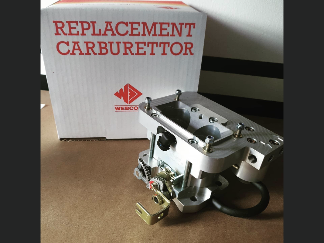

Spotted this on face book today for us folks with a carb and will watch with interested with E10 petrol coming out next year .
So here’s the post
Quote from face book .
That's a funny looking carburettor!
Over the next few weeks I'll be having a play with the Retroject, a complete EFI drop on carb replacement for the 32/36 or 38 DGAS DGAV.
It's got 2 injectors, a fuel pressure regulator, air temperature sensor, throttle position sensor and idle vale all in one.
Hoping to offer a budget CORE4 based ECU to run it soon.
Great for all sorts of old skool ford setups.
The company is called https://diy-efi.co.uk/
I have ask the guy permission to post up his findings and hope he will join us on here to answer the questions

Hi Guys,
I own and run DIY-EFI, it was actually started a few years ago now after I was unhappy with the cost of the ECU when fitting an ST170 lump into my Capri.
I now design and supply low cost ECUs and accessories intended to convert a classic car to EFI.
I don't sell the retroject, I'm just trialing one with my range of ECUs, I might offer a specific ECU bundle in the future with the connectors etc included.
There is more involved with this than just dropping it in place of a carb
You will need a trigger setup (many options on how to do this), a high pressure fuel setup (2.8i tank and pump or a swirl pot) , a few other sensors and an ECU.
It will however allow you to run modern fuels, all the way up to E85, If you fit an ethanol sensor it will adjust itself based on the E** content.
You also get all the other benefits of EFI, great starting under all conditions, spot on idle, and no compromise in fueling across the rev range.
This one is going to find it's way on to a mk3 3.0 Essex in the coming months with a stealth distributor trigger.
Any questions on this or EFI conversions in general feel free to ask.
If some time has passed and I've not gotten back to you give me a shout over at my website or Facebook page.
Cheers,
James

As my vehicle is the test bed for this once its fitted I'll stick up some photo's and video of the thing working.
Not sure when its going on because of the Covid situation and James needs to sort out the Dizzy so it can run a trigger wheel.
Already got the 2.8 tank and fuel pump so once that's in and the fuel lines are sorted it will be all systems go with fitting it and setting it up.
Be interesting to see what the results are but its more of a opportunity for James to develop and test products so he can expand the range services he can offer for some of the older cars out there.
