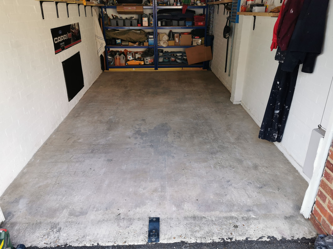

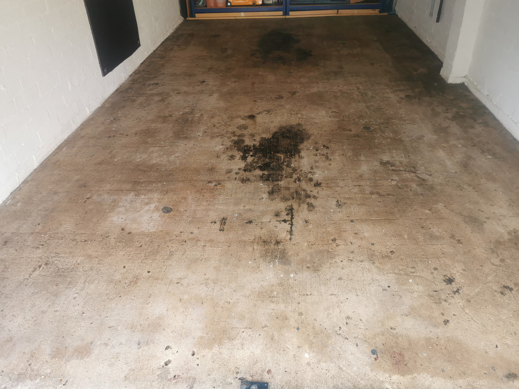

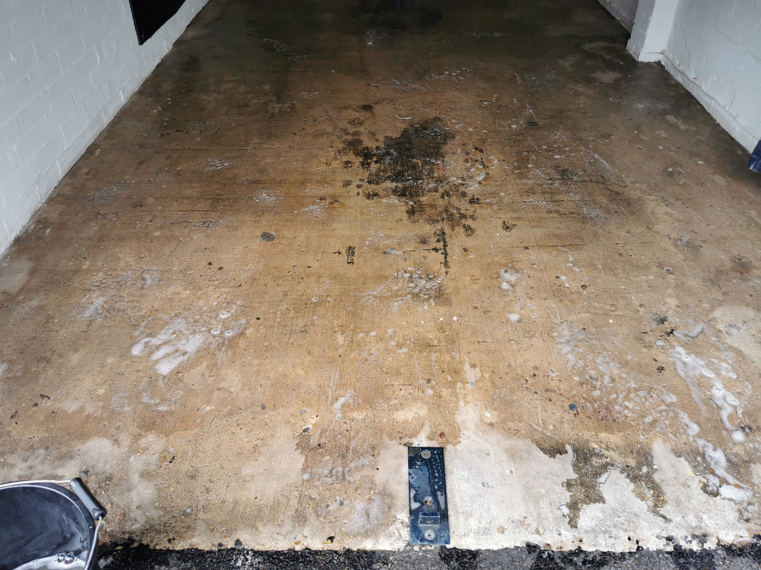

So, after about four years in the planning I finally got around to doing the garage floor. Took a lot of prep work with a hammer and chisel and sandpaper ( no machinery used) flattening off the old clumps of cement and other bits. Decided against the full job of getting the floor grinded and leveled so I worked with what I had and anyway the divets and imperfections give it a proper patina look garage floor :lol:
Anyway heres a few pics. Am well chuffed how its turned out. Totally transformed :)
So, as said hammer and chisel and sandpaper to flatten it best I could...
Then after a good wash, wash and another wash :lol:

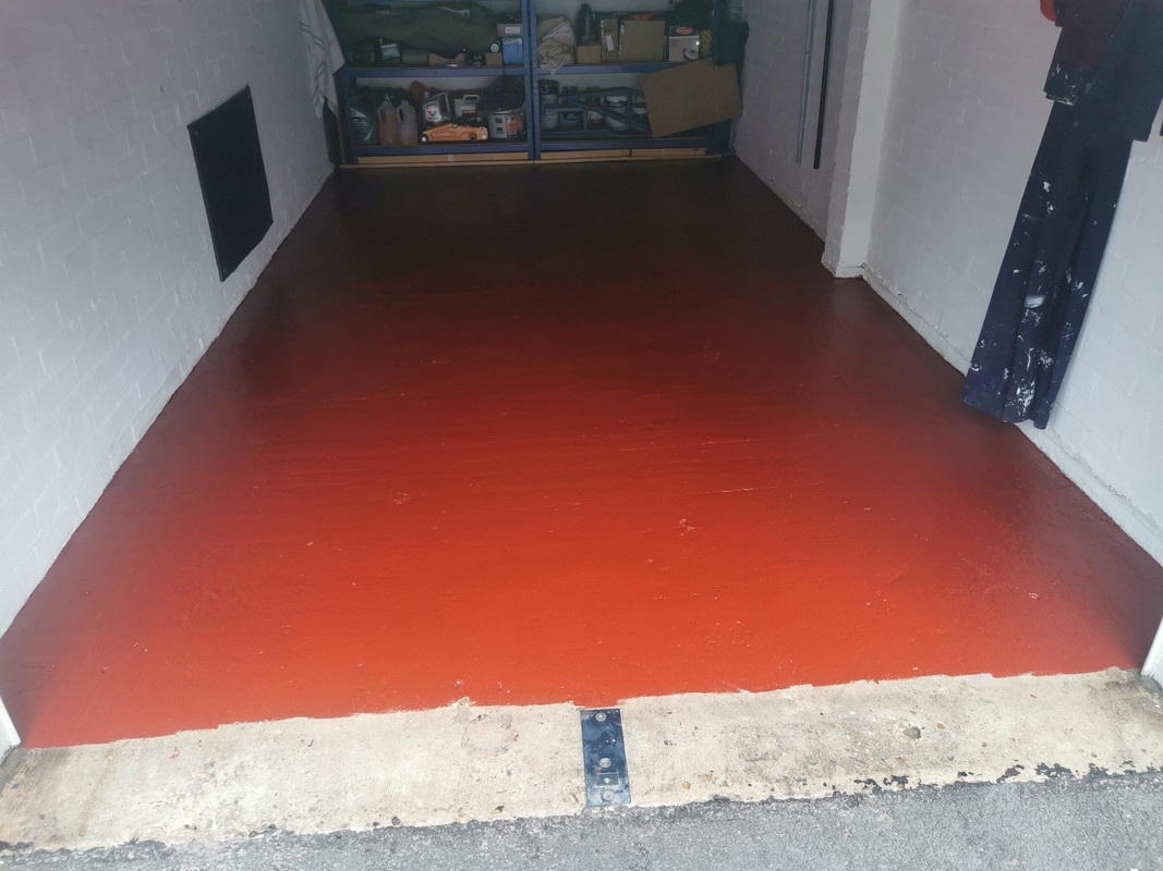

It was ready for two coats of dustproofer/ hardener sealer
Then two coats of the floor paint in Tile Red. Yep I know many do Grey paint but I've always promised myself a retro tile Red floor against the white walls

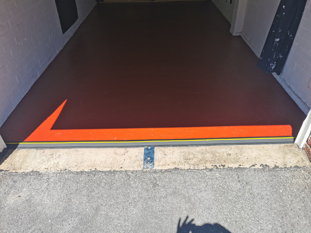

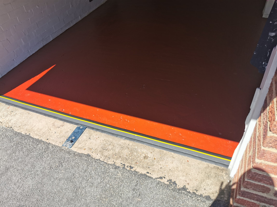

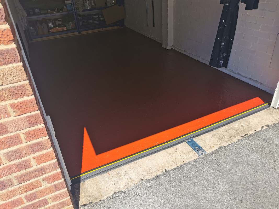

Then this morning I fitted the finishing touch... a weather strip across the front which not only finishes it off a treat but should keep alot of CRaP blowing underneath the door
So as said am well chuffed how its turned out. Now I will leave it a few more days ( top coats were finished Weds) to harden before moving B112 back in. It's right next door in my sister in laws garage so I'm very lucky to be able to park it up in there for over a week. Have bought some nice hallway carpet runners cut to size to lay down so B112 drives in on these rather than the new paint. Will see if I decide to leave these down permanently but knowing me I prob will :wave: :lol:

Nick, I`d leave it as long as possible before putting car in, as I had a lot of trouble with the tyres sticking to the paint even after several days when it seemed really hard. (I think the `sticky` tyre rubber with 1/4 ton pressure for a week formed quite a good bond :roll: Had to use squares of cling film in the end to stop it sticking.

andyd wrote: Sat May 30, 2020 5:26 am have read it can sweat and cause mould etc underneath, so might not bother
Andy,
I`ve had carpet down on a painted concrete floor for years now and it`s been absolutely fine, no damp problems at all. And it`s so much nicer to kneel / crawl on.

I'd suggest it might be a good idea to test the concrete for moisture before laying down any sort of flooring.
